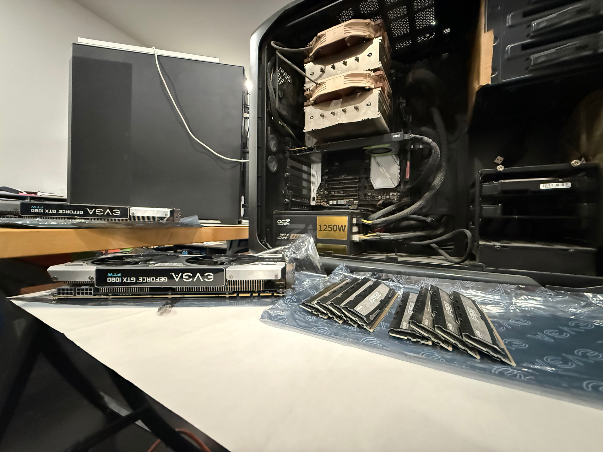

I also have a Broadwell-E that likes to hang, freeze, or crash when it’s been on for a while. It had 8 DIMMs of 8 for 64GB. Eventually I lost some . I replaced them with newer 32GB KIT. That helped some. Mine is basically cooked. Back in the day I was running 8 DIMMs, 2 GPUS and a serious over clock. I increased all core to 4.4GHz, about the time I repurposed it to be a CAD WS it stopped liking it.
That’s the old memory and GPUs. It looks very dusty but that’s mostly paint overspray

Wow, that looks almost identical to what mine looks like.
