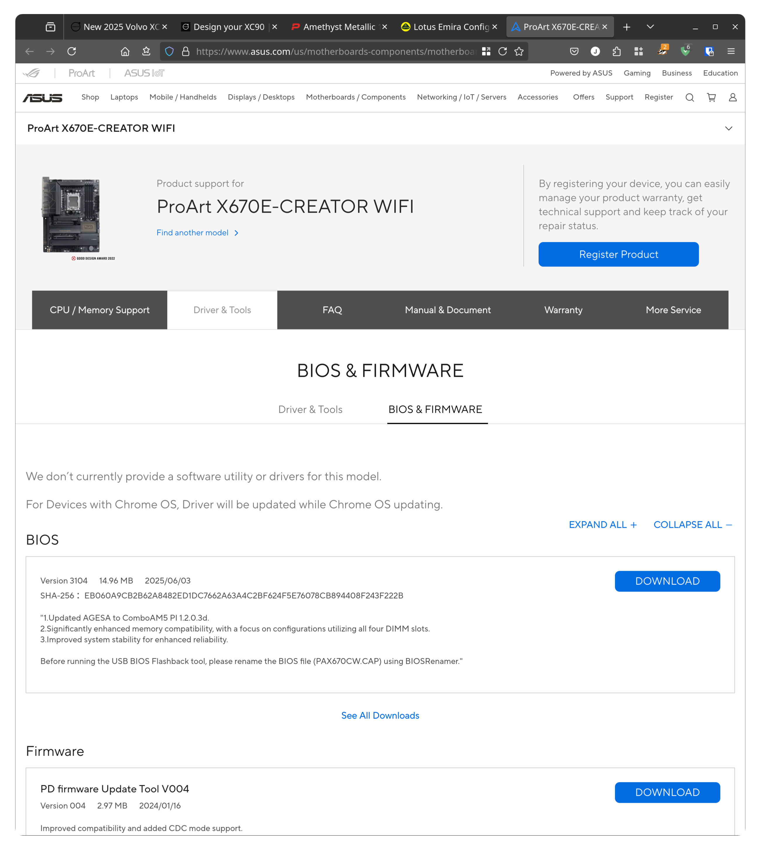

I’m tempted to test 3104, 3003 was really bad

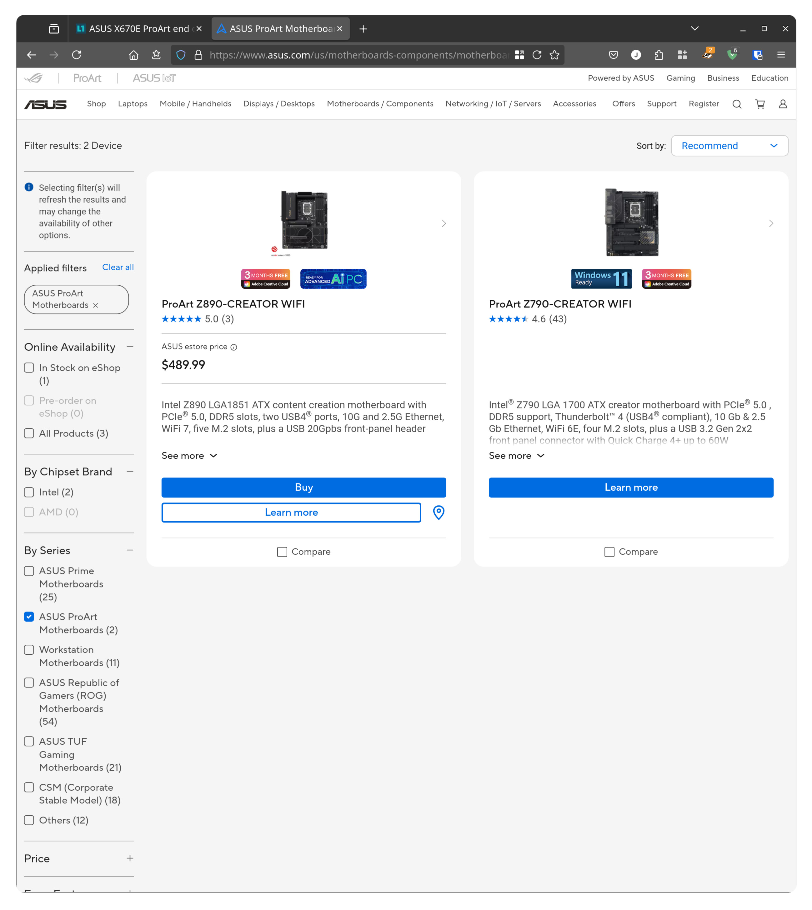

There is also this when I select ALL ProArt motherboards. Even the X870E ProArt is not on this page anymore.
I updated to 3104 from 2704, so far so good.

looks like 3104 is very good, first try with 5600MT/s worked.
I will try to get to 6000MT/s tomorrow

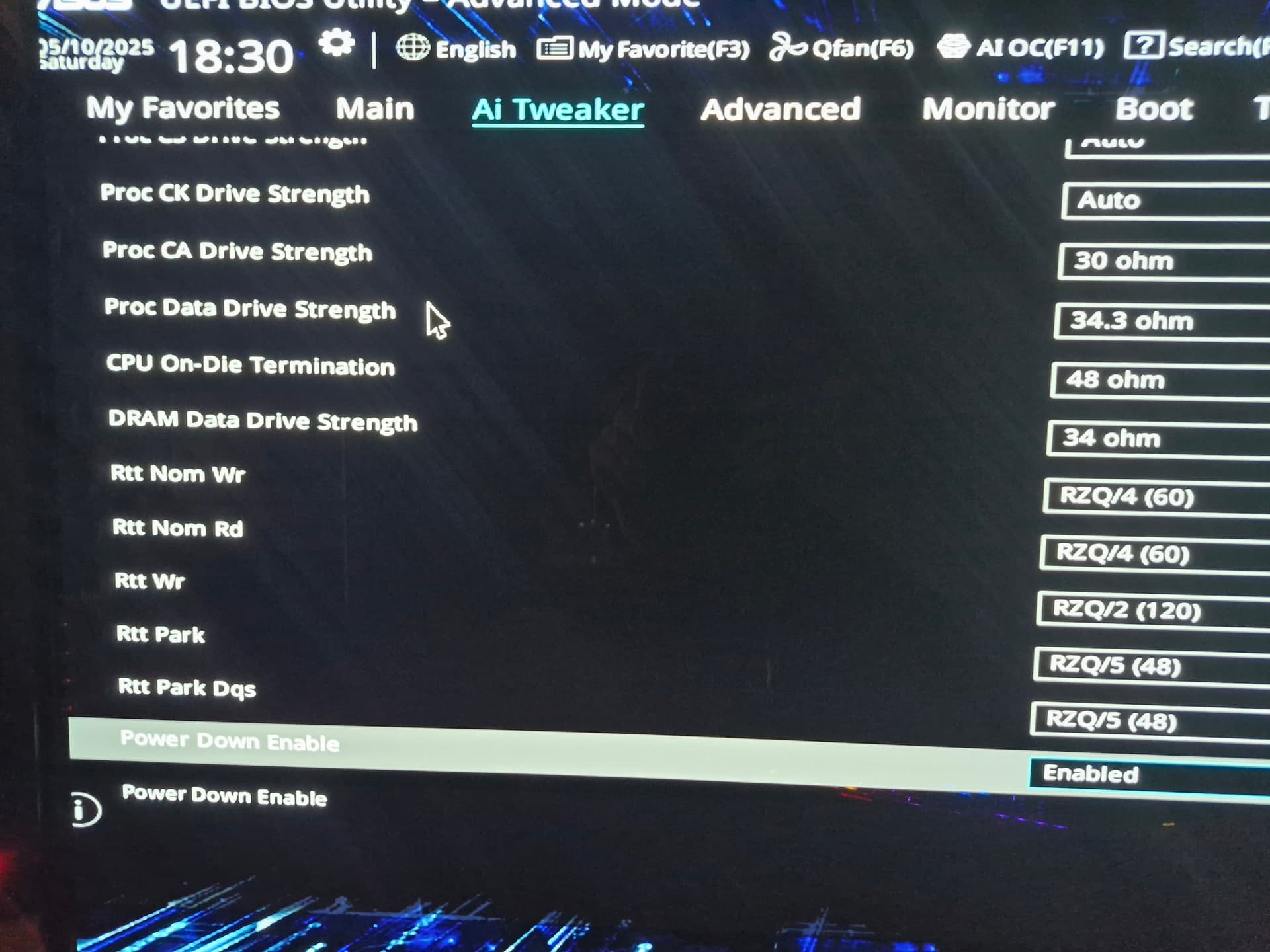

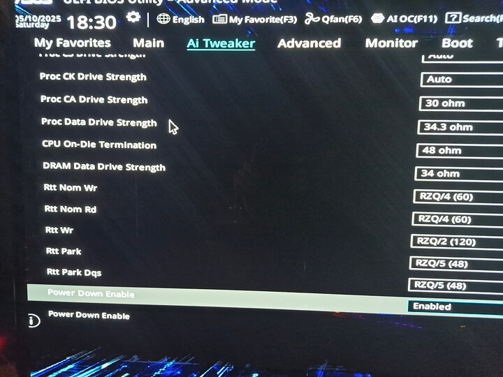

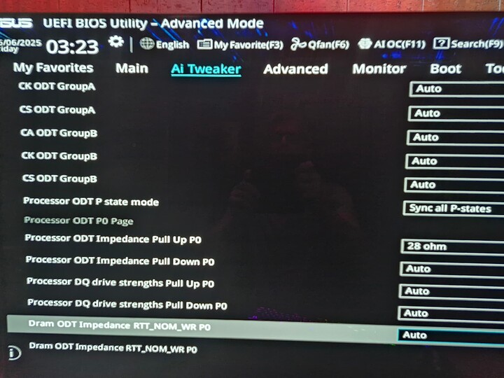

These are the settings relevant for my system to get over 5000MT/s
Thanks, that’s really useful! I’ll be trying it out on my 4x64GB set later today.
well you can at least see the direction, I have Sk-Hynix 24Gb ICs, you may have to change the values ​​a step in one direction or the other.
I use DOCP (XMP) and PBO and my iGPU is active, It will most likely be easier without.
No luck for me, I couldn’t even get it to post at 4400MHz :frowning:
I’ll try a bit more today, but if I can’t get any meaningful progress I’ll just downgrade back to BIOS 2904.
try only Proc ODT Pull Up and CPU ON-Die Term and leave the rest on auto.
