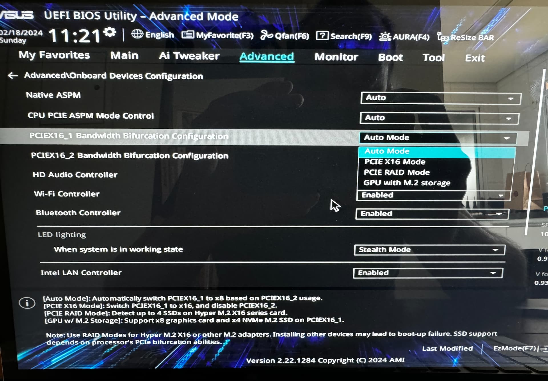

Nonetheless, the options I have is that Slot 1 must be in “Auto” so Slot 2 can be set to x8 or “RAID” (which is only used for their M.2 Hyper card).

I can’t force X8 on the first slot. The X16 Mode and GPU with M.2 Storage disable the second slot immediately.
If I leave Auto, then I can fix the second slot with X8.

In other words, there is no way to set the PCIEX16_1 to x8 manually. The options are “Auto Mode”, “PCIE X16 Mode” (which automatically disable the PCIEX16_2), “PCI RAID Mode”, “GPU with M.2 storage” (also disable PCIEX16_2).
If I set Auto, RAID or GPU with storage o PCIEX16_1, then PCIEX16_2 allow me to either “PCIE X8 Mode” or “PCIE RAID Mode”.
I’ve tried all possible combinations no success.

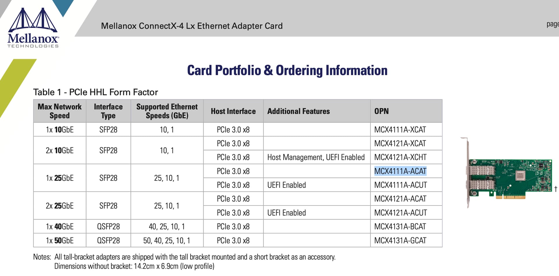

According to the spec sheet, the difference of MCX4111A-ACAT (mine) and MCX4111A-ACUT is that the latter comes with UEFI firmware.
After updating the firmware I now have UEFI support.

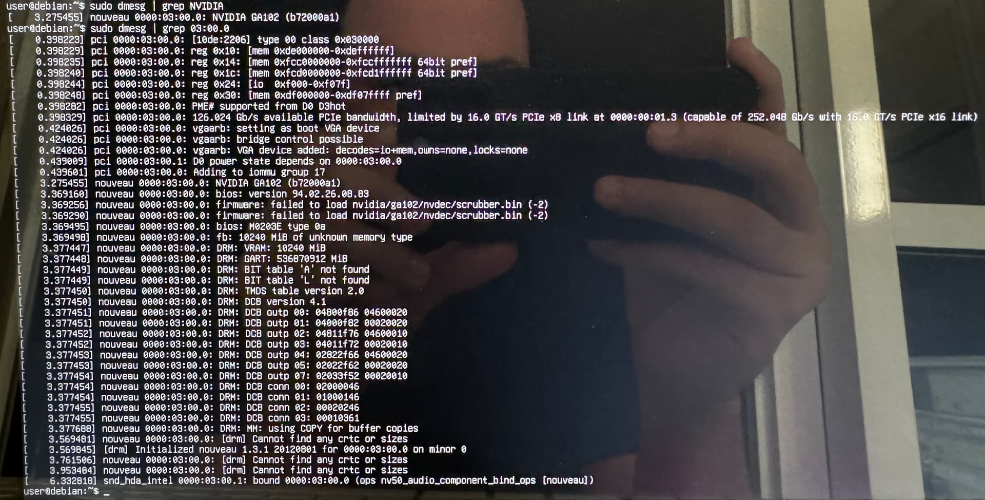

The question now is wether or not because I have a PCIe Gen 3 card on the second slot, the motherboard is making the GPU to work on Gen 3 mode… Can’t find a way on ESXI to get it. Will have to fallback to linux to test out…
It doesn’t. It’s a general feature of bifurcation that it is possible to have different PCIe gens. But specifically, I have the same board, a RTX 3060 and a connect-x 3 card, and here the GPU is on PCIe gen 4 and the NIC on PCIe gen 4 :wink:

Indeed it is detected at Gen 4 x8.

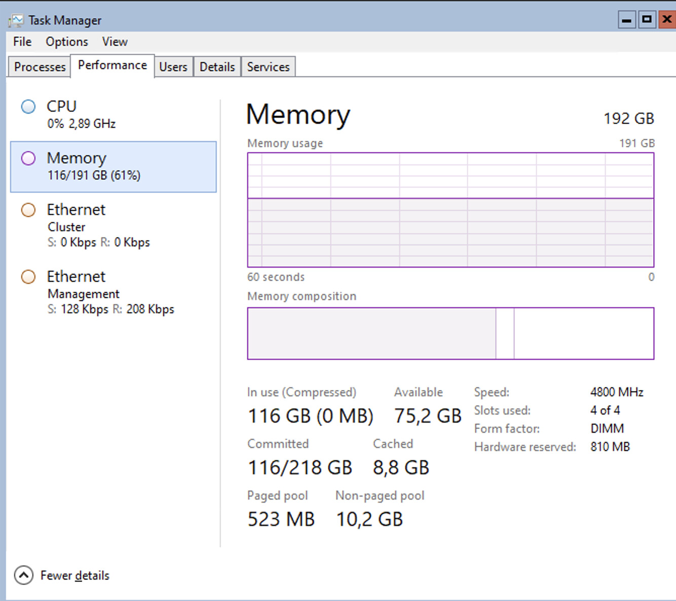

Yeah it works just fine:
However, I was only able to get it stable at 4800Mhz. If I get more than that it just don’t POST. I’m using 4 Kingston Fury Renegade 6000MHz, DDR5, CL32, XMP KF560C32RSAK2-96.
I wonder if even though the OS is correctly reporting total memory on the motherboard, the CPU is only able to use 128GB of it? The AMD website clearly states 128GB max RAM for the 7950X3D. A failure will only occur if a program tries to access above 128GB, and few programs use that much RAM. Again, just wondering.
I did ran almost full and it works without problems. Created a big Hyper-V VM with 164Gb and it worked just fine. Both Mobo BIOS and OS detect the memory properly.
