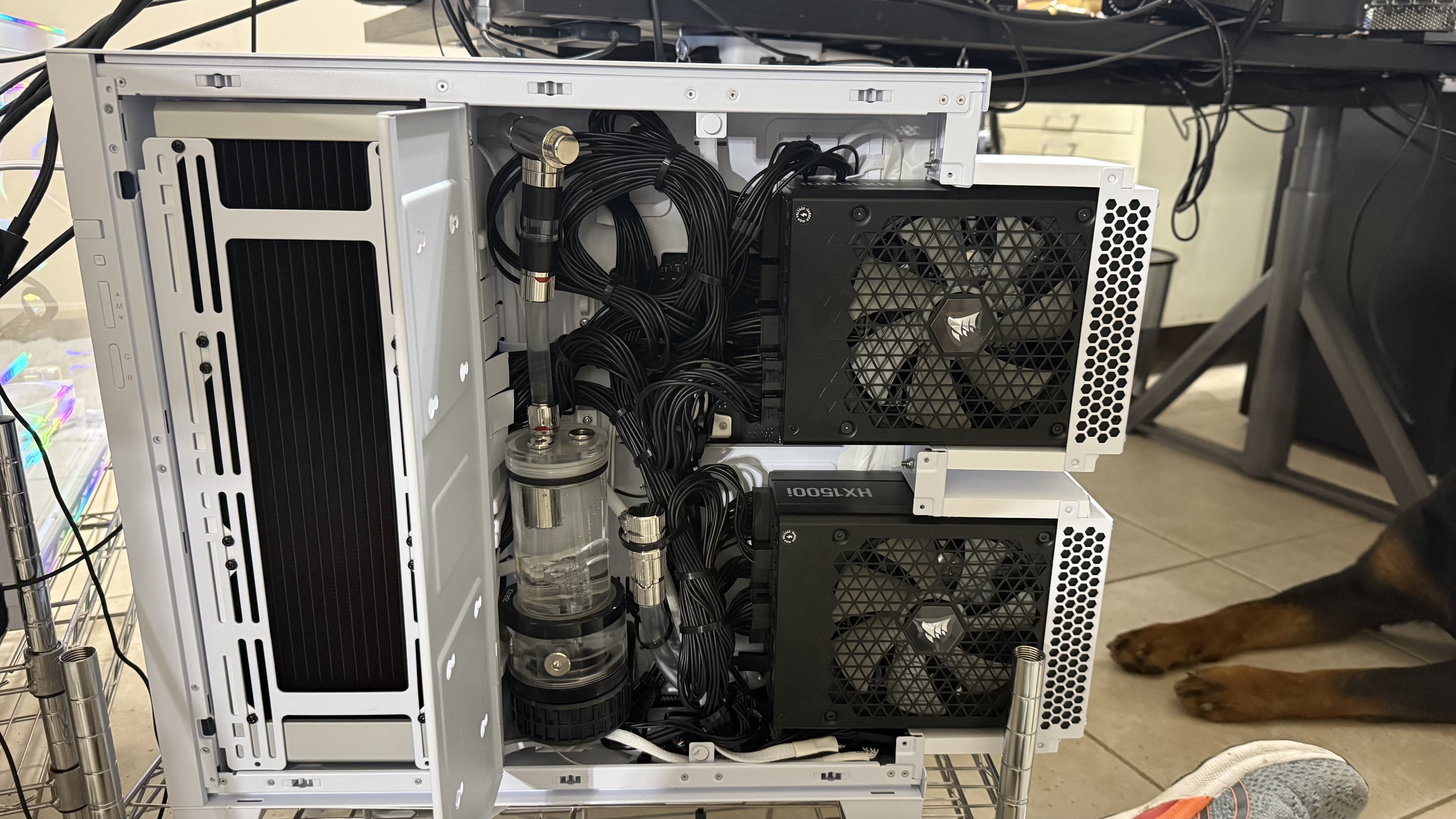

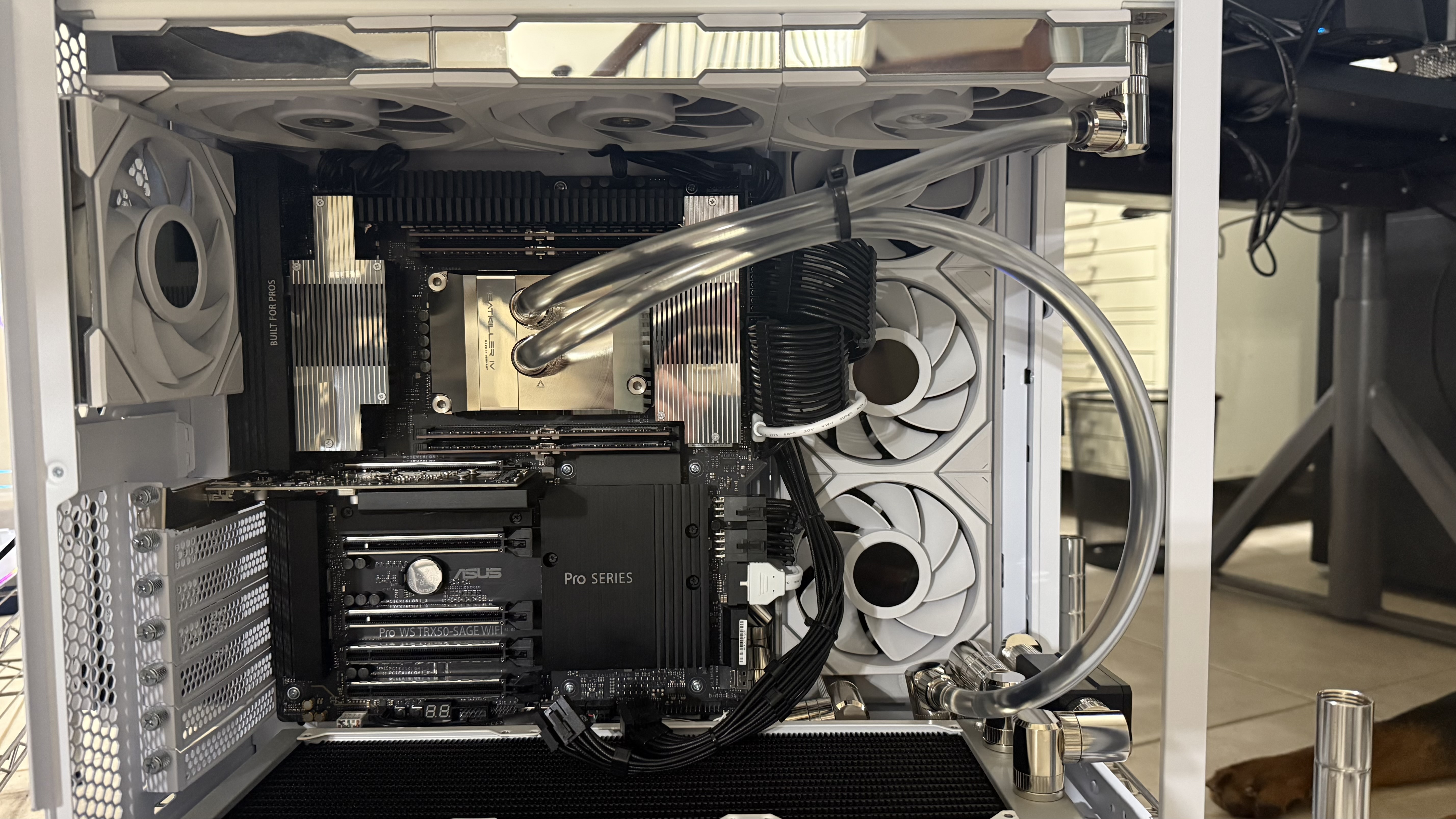

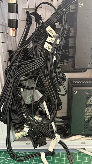

take a pic of how you have it cabled?
got any red LEDs on the board? The pcie power connector on the motherboard at the front is non-optional. it supplies power to the pcie slots for gpus. Sounds like your problem.

All power connectors on the motherboard are plugged in. The 2 dangling cables are for the RTX 3070 which I removed in order to make the computer usable with a GT 1030.
The Qled for the GPU (white) stays lit up and the code on the motherboard stays at 26, then 27, then 28 after 5-10 mins and that is as far as I have waited for the boot to complete. With the GT 1030 it boots within 30 seconds or so.

im real sus of the dual PSU setup. go back to one psu or make sure both mobo right angle connectors come from primary PSU
Same behavior with 1 PSU :frowning:
