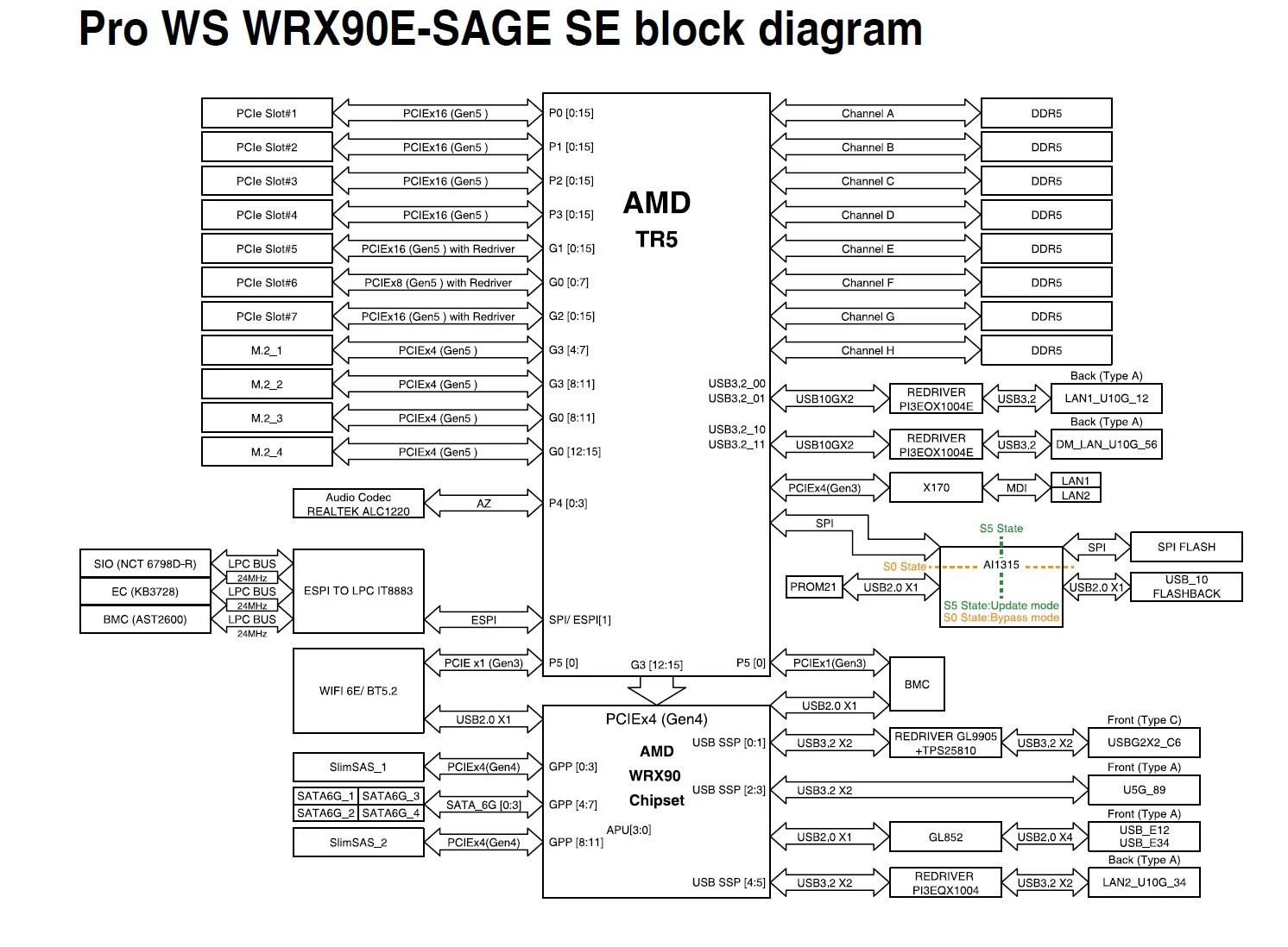

I would expect 6 of the PCIe slots to have x8/x8 available if it is implemented, because they nerfed the 7th PCIe slot on the 90E compared to the 80E (it is only x8 instead of x16). Not sure why they did that, guess to add dedicated M.2 slots without sharing bandwidth with U.2/SlimSAS instead.

For the record, it is the 6th slot, not the 7th, that is only 8 lanes.
Which is great, because it makes the 7th slot ideal for a large 16x GPU, so that it doesn’t block other slots.
Is it slots 4,5,6,7 again that has the built-in re-drivers on the WRX90?
Those have honestly been a huge pain to deal with in the WRX80, ASUS probably didn’t use very high quality re-drivers. I’m beginning to see the wisdom in packing more MCIO ports closer to the CPU instead of slots. You can drive or re-time the MCIO however you need later.
I think only slots 5, 6, 7 have redrivers. Also, still not much word yet on adding x8x8 support for the WRX90E. A shame
Oops, my bad! Yes I meant 5,6,7, it is the same with the WRX80 versions also.
