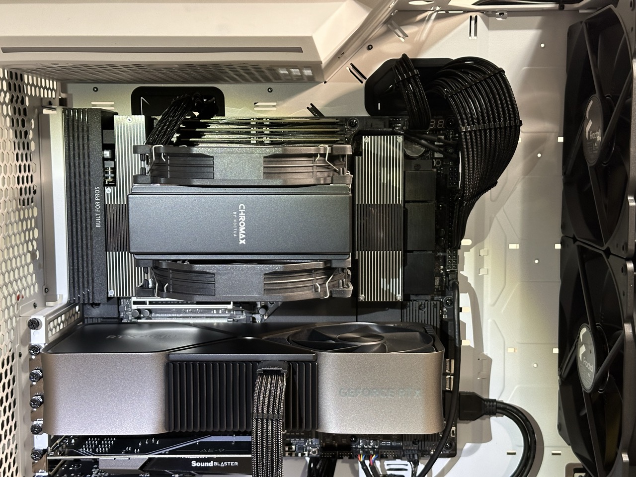

Alright, here’s my update after ordering a replacement ASUS WRX90 and a Kingston 256GB kit (just in case the G.Skill kit was the issue):
  1. Installed new mobo, CPU/heatsink, 2xNVMe drives, 1 piece of memory from the 32GB G.Skill kit, and 1 4090 FE (no other PCIe cards). Result: Same thing - Code 92!
  2. Cleared CMOS, tried again. Result: Same thing - Code 92!
  3. Tried 1 piece from the Kingston kit (on the QVL). Result: Same thing - Code 92!
  4. Connected both supplemental PCIe_8p power connectors and tried again. Result: Same thing - Code 92!
  5. It was at this point I decided to try the only thing I had not tried before. I pulled the 4090 FE and replaced it with an ARC A750 I had lying around. Result: Immediate POST (with 1 G.Skill DIMM).
  6. I put the 4090 FE back in and tried again. Result: Immediate POST!
  7. I added all 7 of the remaining DIMMs from the G.Skill kit. Result: After a couple minutes of training, POST!
  8. I increased the clock to 6000 MT/s for the 8 G.Skill DIMMs (kit is rated at 6400, but I only went to 6000). Result: Immediate POST!
So far, everything is stable.
Takeaways:
  1. The original board was likely NOT defective.
  2. The GPU was the issue, but I don’t know why. And, to clarify, I am NOT using either supplemental PCIe power connector at this point – should be no need with a single GPU, but more on that in a sec.
  3. The system appears to be stable and has been running for the past few hours without issue.

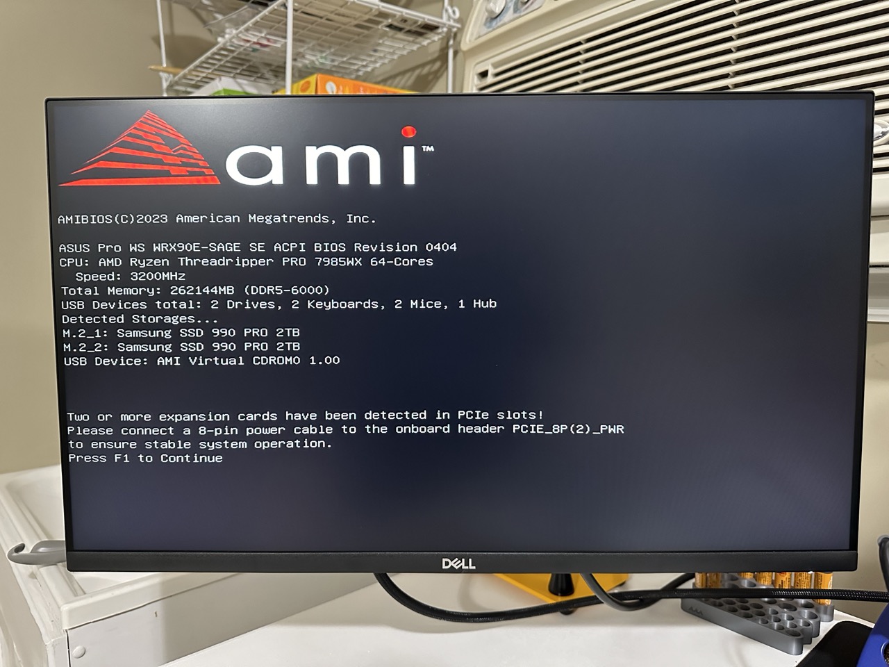

  • I added two (2) additional PCIe cards – an Elgato 4K capture card and a Sound Blaster Both consume VERY little power (well under the 75W slot limit, obviously). However, the BIOS still complains that because I have two (2) or more PCIe cards, I need a supplemental PCIe power input connected – which seems dumb. Not sure if there is a way to ignore the warning in the BIOS, but worst case I’ll order a matching cable from CableMod.
