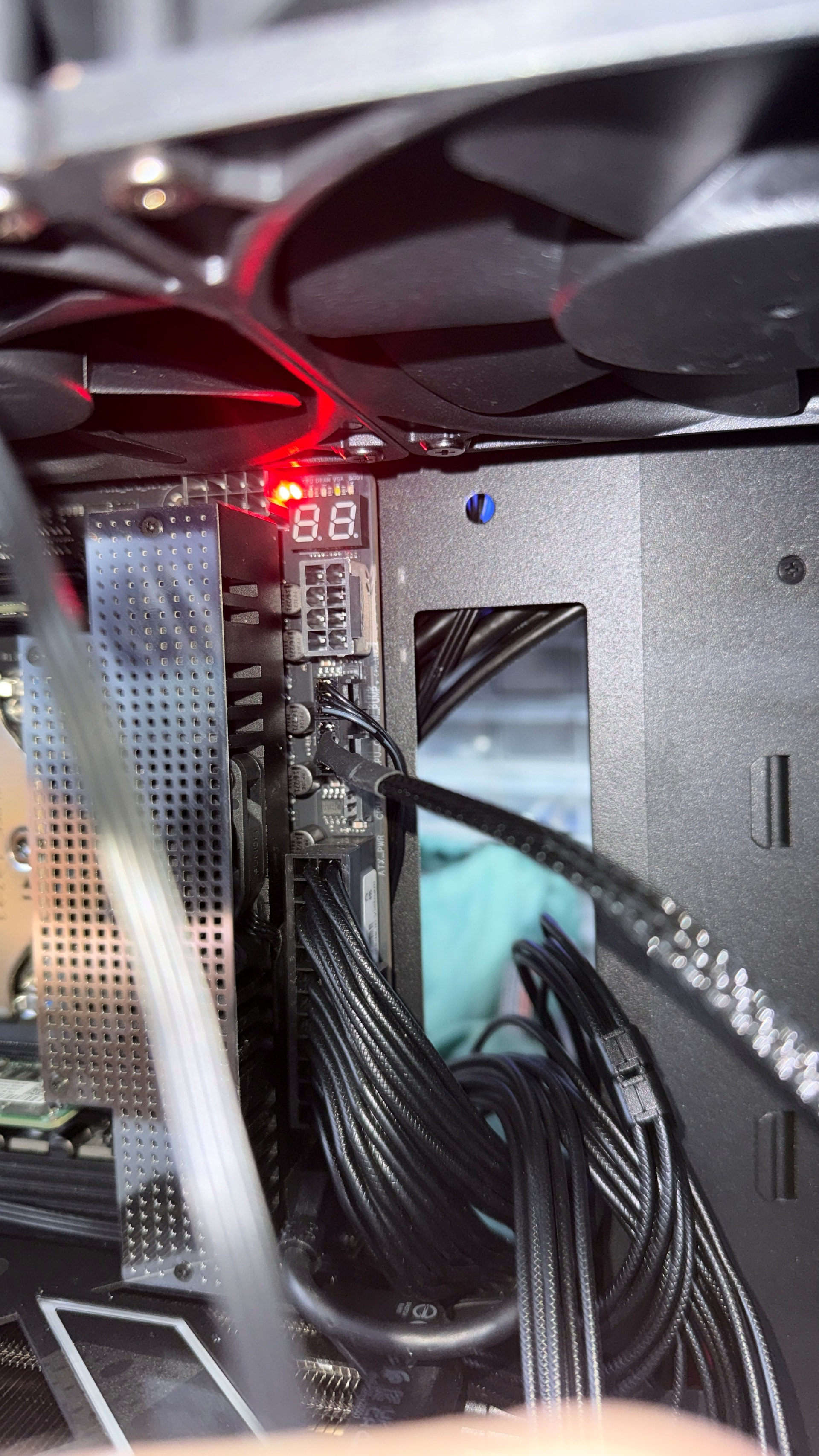

I just purchased an ASUS TRX50-Sage Wifi A and unsure of what plugs to use for power. The manual points to one set but then an online manual points to a different set of plugs. I only get a single red light at the top right corner (where the Q codes would appear) and I get power through a case USB. Everything is brand new, tried it with one PSU and another PSU of the same type (in all respects). The CPU doesn’t even get warm. Any suggestions?

Appreciate the link to the manual. I had seen the manual but didn’t see what the one red light meant. It looks like an issue with the CPU itself (threadripper 7XXX), upon inspection, the underside shows what looks like a burn. So, just speculating but it looks like either the MB shorted the CPU or the CPU shorted the MB.
If neither part is secondhand, I would try to get my money back. If both parts were purchased secondhand and there is no warranty, I would write off both parts because you will never know which part was faulty when purchased.
Both from Amazon and with warranty, already started the return process and ordered new. Hopefully 2nd time around is better!
