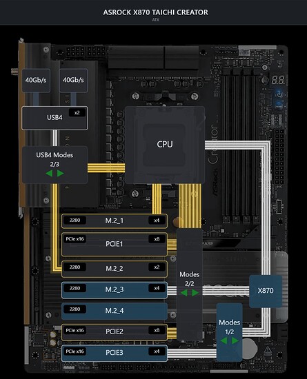

I found this relatively new motherboard for AM5 and would like you recommendations for a potential “budget” dual GPU setup and not spending thousands on threadripper and trx boards
Its the cheapest PCIE 5 dual X16 with bifurication motherboard i can find, and it honestly looks pretty solid, enough cooling on the backside and front, 10gbe + 5gbe ethernet

This looks to be a nice board. It really addresses a lot of the issues I have had with AM5 boards.10Gbe + 5Gbe should be pretty much standard except on the lowest tier boards. Wifi 7. Slot spacing and lane usage is pretty good (although different needs may prefer different this is good for multi GPU.
However, its pretty expensive for what it is.
Its natural competitor is probably Asus ProArt Creator
Are you getting that board for dual GPU, or because you need x8x8 bifurcation?
The 2nd PCIE slot can’t accommodate anything thicker than 2 slots without blocking the last row of IO.
Yeah, ofcourse it will be x8/x8 on am5, for rendering/simulation and gaming on one card it should be fine to have that kind of layout, without running into a bottleneck
Apart from the cables i wont put anything down there, this should be fine right, or are the cable “mounts” too large if there is a larger GPU like a 3 slot design?

Depends on the cables and the GPU’s cooler and shroud design. In general, yeah, there can be trouble but usually it’s not too big of an issue to plan around it if it’s not an MSI board with PCIE_PWR1. Don’t forget about also arranging the case for the lower GPU’s air intake.
I am doing dual GPU on the asrock livemixer b850, but their x870 is the same price now. That gives the lower GPU 4x4 speeds, which is OK for what it does.
Also consider the gigabyte b850 AI TOP, which IIRC has x8 x8 slots and dual 10GbE. It’s one of the very few AM5 consumer boards maybe intended for dual gpu, however I think Puget Systems doesn’t use it, for what that info is worth :slight_smile:
I think if you’re doing twin gpus, the x8 x8 may be important, but for me one is AMD, the other nvidia and I don’t have any software to use two at once, so I was OK with one being less connected.

One of the usps of this particular board is the dual nic´s and also,
the x8/x8 pci-e capability which is really unique for a X870 board.
the only real downside i have with this particular board is the sata port configuration.
Basically because this board is only single chip set its pretty much loaded.
And they had to use as media controllers for all the sata ports, which in most cases won´t be that much of a big deal.
However in certain circumstances it could be a thing.
But other than that for it´s price it´s really a great deal i would say.

x8+x8 muxing with two slots spaced for dGPUs is fairly common on AM5 boards starting around the Taichi Creator’s price point, pretty standard the next tier up. B850 AI Top’s unusual more for being a high end B850. Asus did x8+x8 on B650 ProArt but removed it on the successor B850 that apparently was so bad it got killed before shipping. The stub page for the B850 Creator Neo that may eventually be a replacement doesn’t say.
Downgrade to chipset 3x4(16) slots instead of 4x4(16)s, though maybe it’s worth it if you have enough USB4 use cases that are actually 40 Gb.

Yeah, the way I would actually USE either the b850 or x870 would switch bandwidth away from the TB4 ports if I remember correctly.

X870 and X870E typically dedicate an x4 CPU PHY to the ASM4242. The exceptions are a few MSI boards that x0+x4/x2+x2/x4+x0 mux it with an NVMe.
