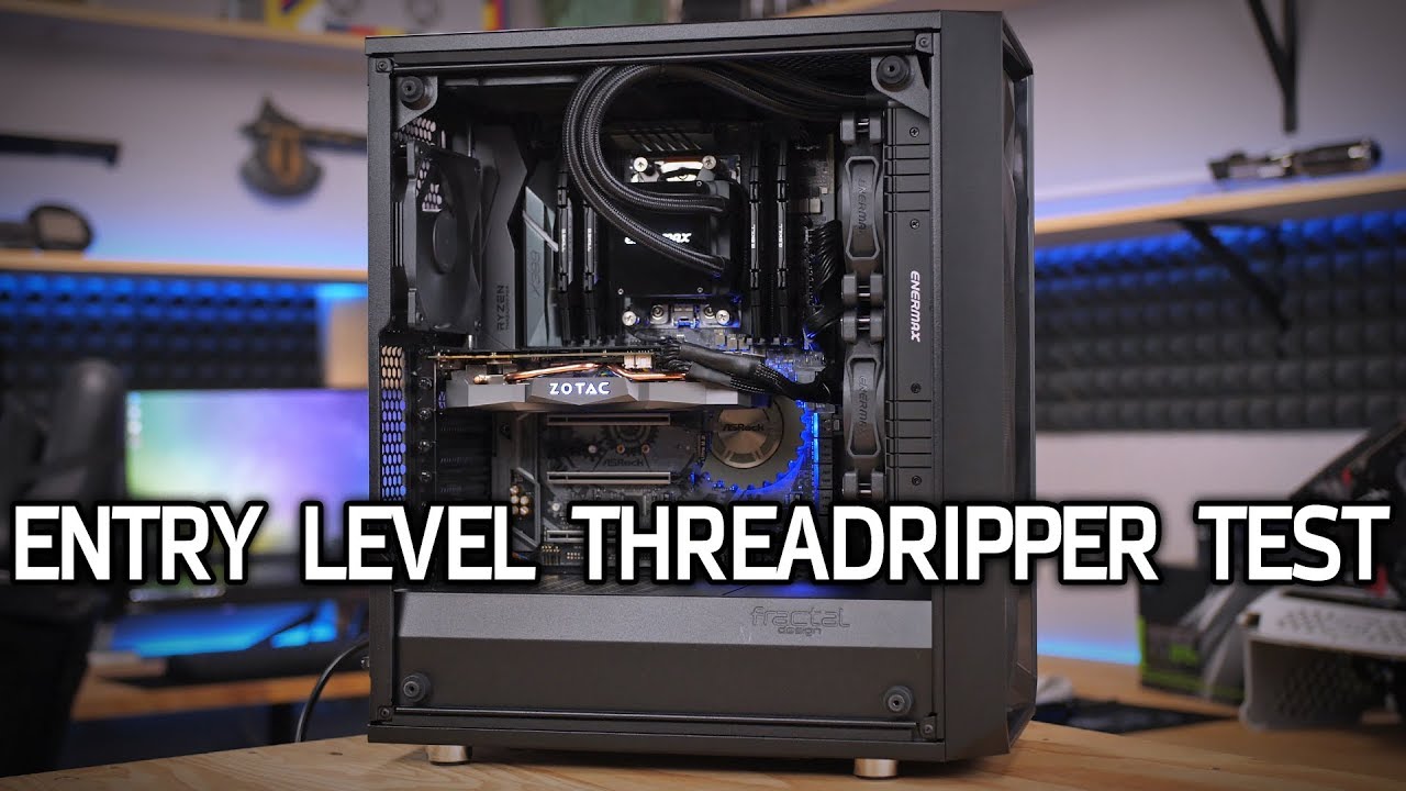

Paul from Paul’s Hardware actually had initial trouble with the Taichi because of the strict QVL requirements. I think he tried some Trident Z RGB that was able to run at 3200 in his entry Threadripper build.
