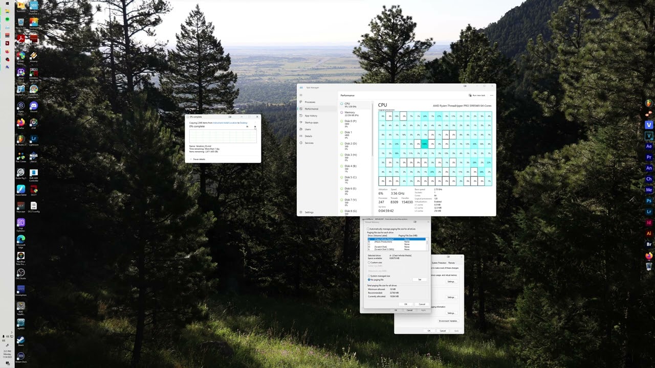

I just turned off the paging thing and for a brief moment things were moving ok with the transfer but its went back to being slow and the whole computer lagging. Here is a video going over everything.
