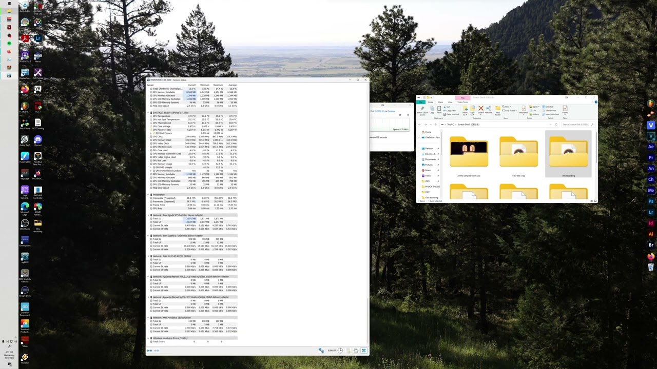

@wendell Here is the Hwinfo video.
nice thanks, lots of good info here

the power deviation thing isn’t anything to worry about HOWEVER I never saw your cpu use above 170 watts, and the PPT was set for 170. Did you do anything with EDC/PPT or install ryzen master?). That cpu should cruise at 200+ watts all day long under heavy load
(might run cinebench real quick with hwinfo64 open and scroll all the way up and down).
I was also looking for the whea error rate in hwinfo64

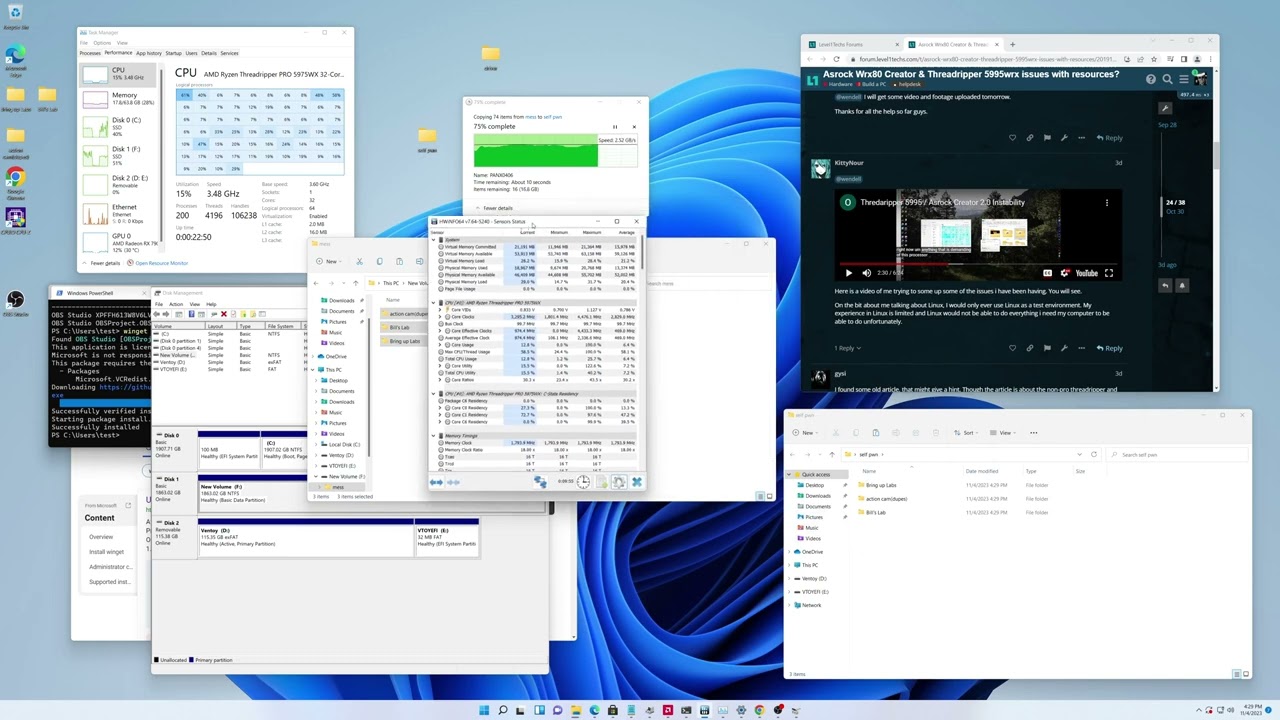

This is a long rambly video but you will at least see what is continuing to happen even more. When running cinebench i had now whea errors but interestingly after recording this video i tried to do the file transfer thing i was doing and see what hwinfo would say and it kept crashing and erroring out. I will post a video of that as well.

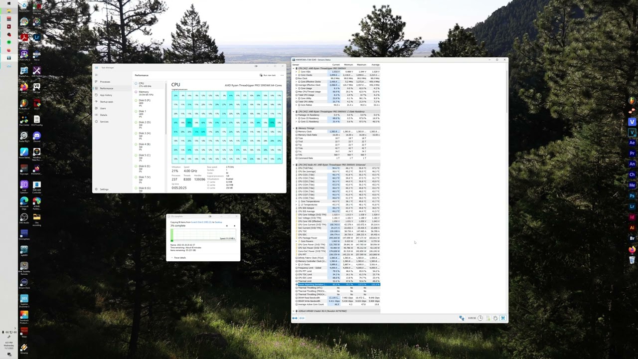

Here is that video showcasing Hwinfo not responding upon file transfers.
