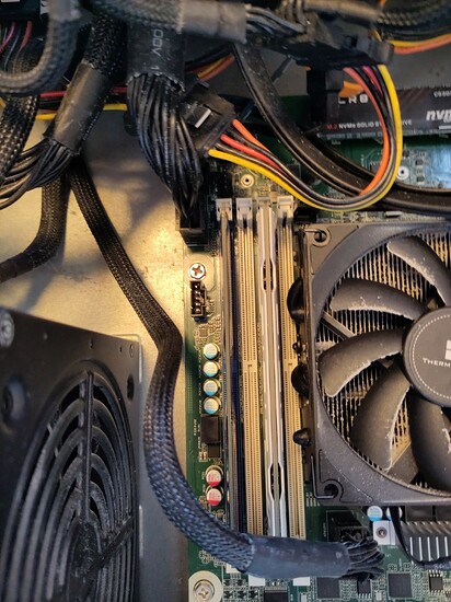

I got this board a while back and fitted it with a 3900x and a cheap thermalright cooler and 2x16 gigs of RAM.
The issue is I now need more RAM and because of the orientation of the socket the cooler covers up the innermost DIMM.

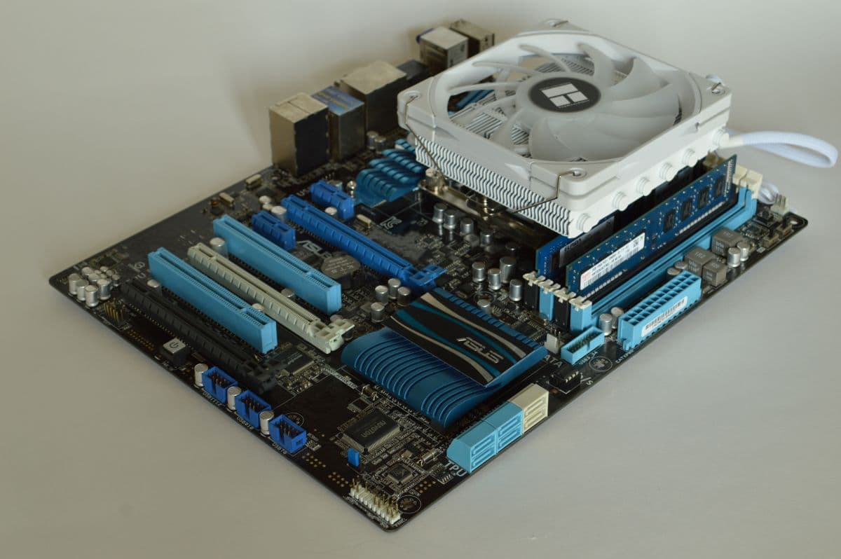

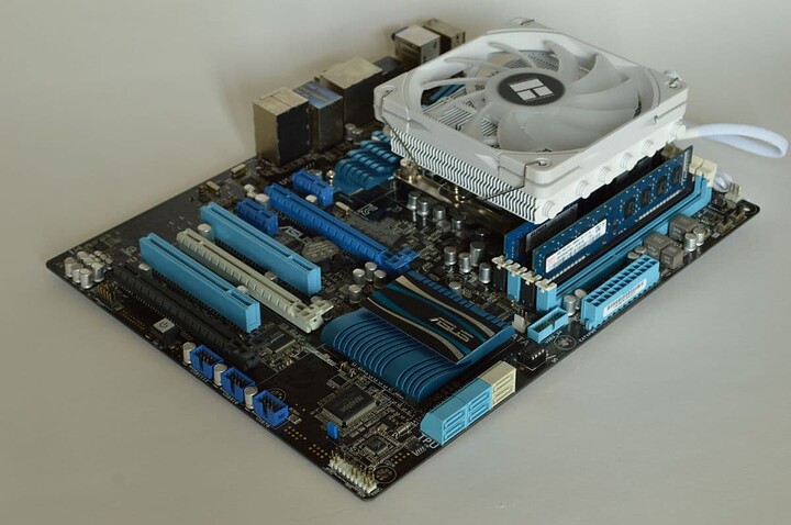

It seems to fit fine and is reasonably priced. I’ll grab one when they are in stock :slight_smile:
Edit: The socket on the x470d4u is a little tighter than on the pictured board + the mount is rotated 90degrees.
Edit 2: It’s the socket that’s rotated, not the mount. It should fit.

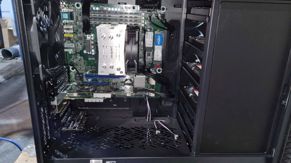

This is with a be quiet! Pure Rock Slim Tower cooler (cooling a 2700x) and 4xKingston KSM26ED8/16ME RAM
The picture I used, was just a reference grab [heatsink hovering over RAM]
That’s a cheap cooler, how are the temps?
about 62C @ 30% load
