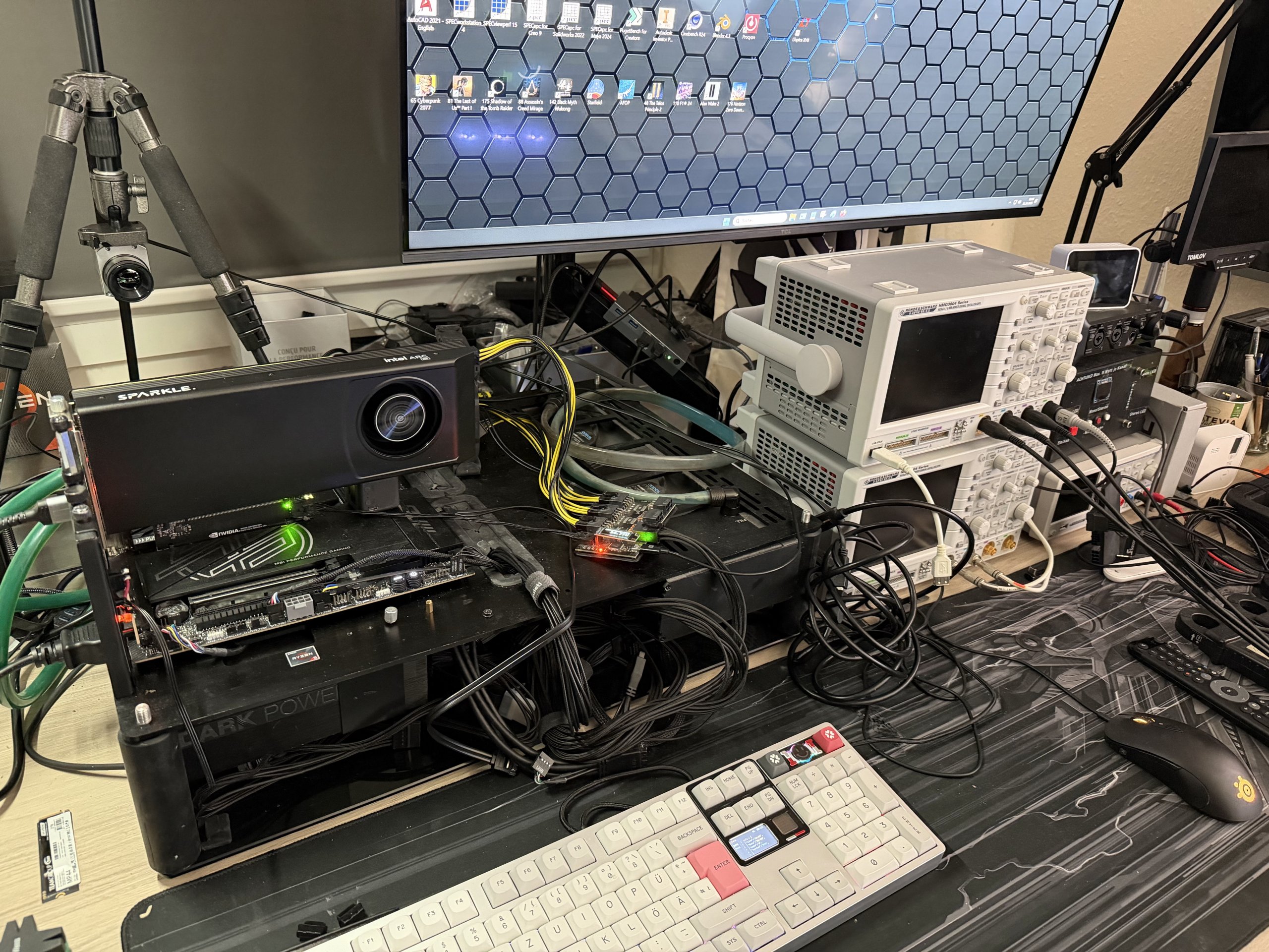

My B70 arrived just about a week ago. I haven’t spent much time with it yet, but so far it’s pretty decent for the price. I’ve had the best results with Vulkan running Qwen 3.6 27b.
I mostly bought the card for SR-IOV. That’s where the Arc Pro lineup becomes an unprecedented value IMO. Being able to partition it out to multiple VMs is awesome.
Overall, they’re competent cards with a promising future, but the software stack still needs a lot of work. Once the Linux 7.1 and 7.2 kernels ship things should improve.
So far I haven’t had any major issues aside from this multi-monitor bug:
