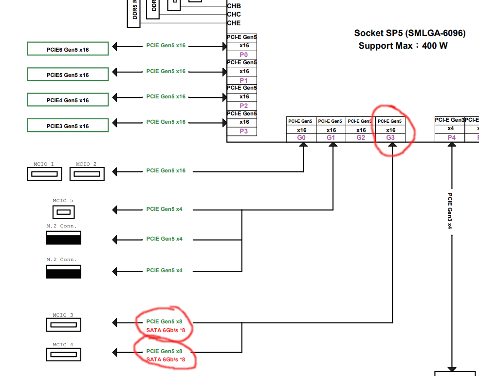

On the ASRock board, the two MCIO ports can connect to 8 SATA each. Are these SATA connections sharing the 6 GbE bandwidth, or does each SATA connection have a full 6 GbE bandwidth?

That one. On all EPYC generations, one of the “SERDES” ports supports both PCIe and SATA, and SATA is supported by turning one of those RX/TX lanes into a SATA lane, repeated 8 or 16 times. The topology diagram in the manual gives a clue:
