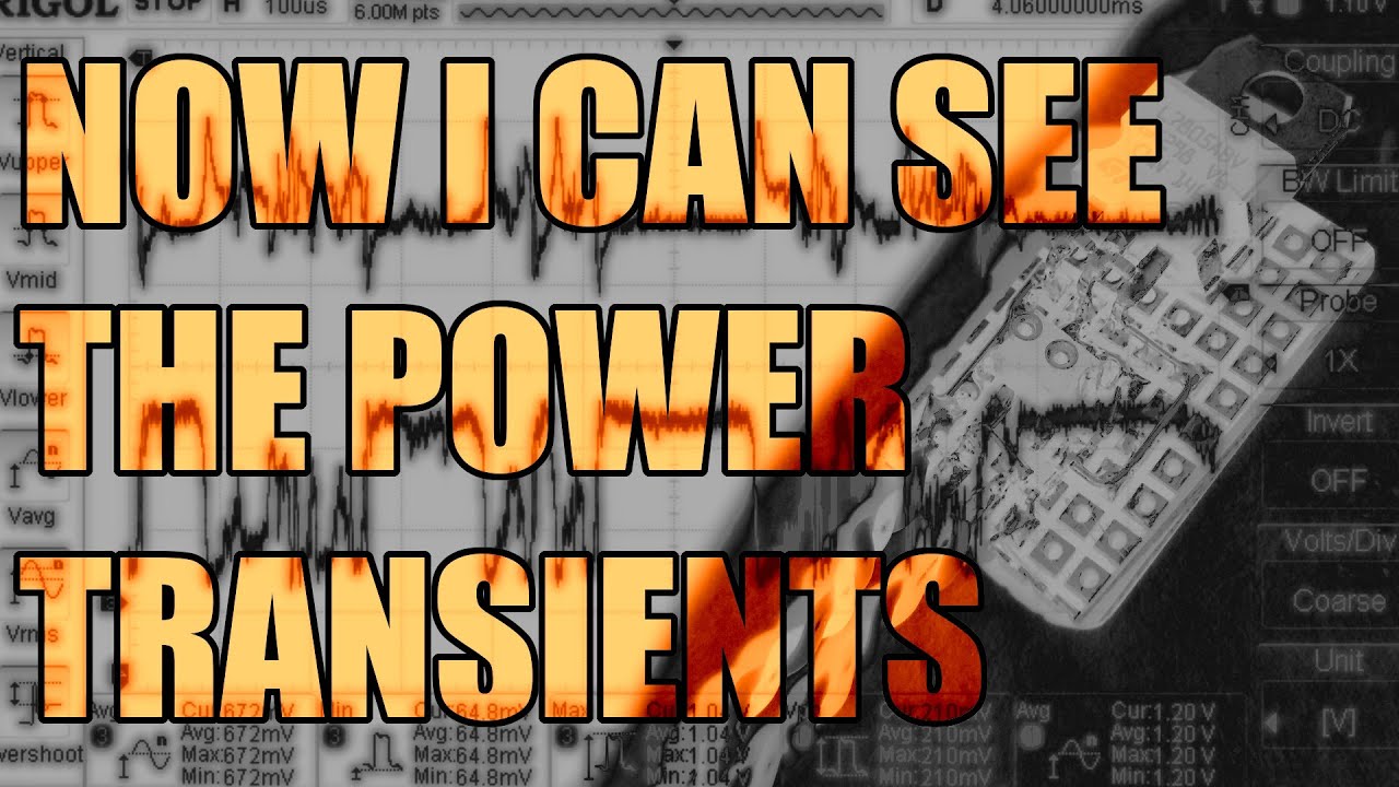

Gamers Nexus has a video on the topic of transients, if you wish to learn more.

Saving the 750 was the original plan⌠I might just stick with that. Thanks for the link, this makes total sense. I am not sure why this is such a problem though. Why canât we make a band pass filter after the PSU and before the MOBO, after the PSU and before the GPU, and so on. Take those spikes drop them in a capacitor, and let that charge those useless rgbâs lol. Good video.
Bulzoid, there is a guy who knows what he talks about⌠what is really funny is I see the nasty of the power flux, and it reminds me of when I was recording music. It is very similar. Thanks for the link. Maybe I just go splurge on a 1200 watt, and get it over with. LOL
