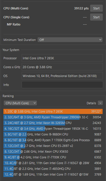

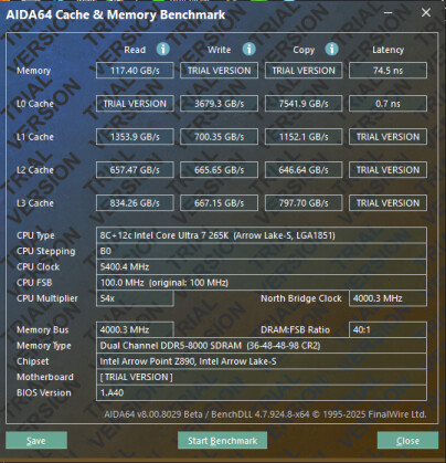

After many weeks of tinkering, I do believe I have something that is stable for an overclock.
Mostly asking for advice to see if I have left any stone unturned.
At current my overclock is 5.6 on 2p, 5.5 on 2p, 5.4 on 4p, 5.0e. CPU Core Voltage 1.36 DLVR disabled.
d2d and ngu is 2.8 I have a rather poor/mediocre sample and it refuses to go faster than this.
Reason I’m looking to make sure I’m leaving no stone unturned is I’m about to go to a custom loop for the 290k.
thoughts/ideas/opinions welcome.

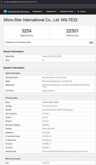

I cant have 3 photo in a post so i have to reply with this one

You’re about 10% better off than me on Cinebench, but I’m currently just running 200S Boost. I also noticed that there’s quite a spread between Geekbench Windows and Geekbench Linux; Gigabyte Technology Co., Ltd. Z890 AORUS ELITE WIFI7 ICE - Geekbench from the last time I ran it, and I think that was XMP On + stockish power limits + 5.4 on all P (1/2P at 5.5) with Es either left alone or 4.8. Seeing how relatively minimal the headroom really is, I like having relatively stable settings that are about 3 clicks from stone default more than trying to eke everything possible out of it.
Edit: Yeah, 2234/36050-36400 CB R23, and here’s “default” (200S Boost + Gigabyte’s High Bandwidth/Low Latency toggles) Geekbench Gigabyte Technology Co., Ltd. Z890 AORUS ELITE WIFI7 ICE - Geekbench
