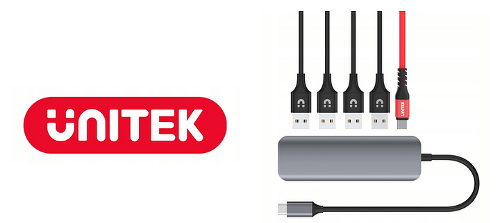

There are, search for usb-c hub/adapter, including Baseus WKWG030113, Unitek H1107B and many others…
