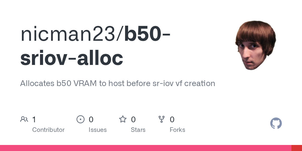

Because I want to keep maximum vram available for the rtx pro I set mutter to use the B60 as primary card. I then use vramfs before creating the VF so that I have room to spare for smaller 7-9B class LLMs to run on the B60.

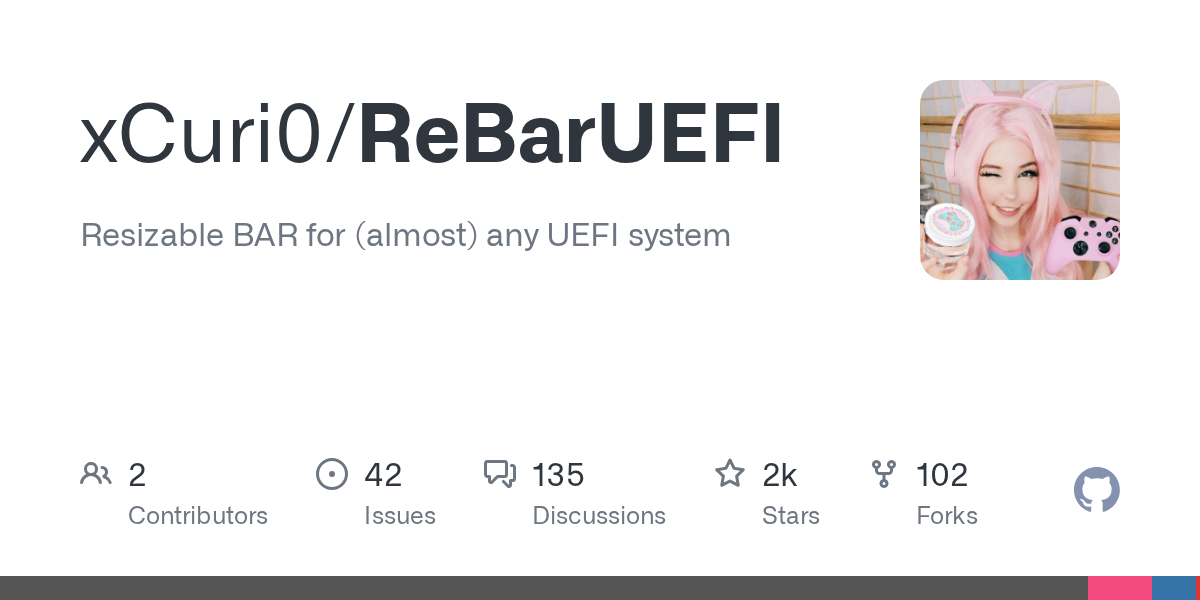

I had to hack my old BIOS to add support for Resizeable BAR so Windows will work. The link is floating around in other threads too, but thought I’d drop it here again.
After enabling Resizeable BAR, I saw very small improvement in LLM model load time with my non-Arc gpus (didn’t have before/after experience for Arc), but there were a couple models that I think sped up about 20% for inference, which seems bizarre to me since raw inference should not be affected by ReBAR. It may have just been a weird fluke, but I guess I’ll see.
Hey Nicman23 - great project!
I added a few features if you would consider the pull request :slight_smile:
so i have been having a weird issue. if i shard 2gbs for a windows vm and leave llama.cpp idling with mlock, the system consistently crashes after a random x hours, that can be 10 or 2
