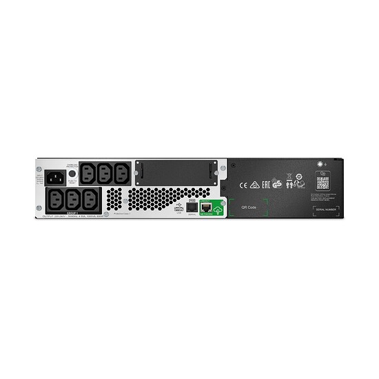

APC SMX1500RM2UNC Noise Level Suitable for Bedroom Office?
tl;dr I don’t mind a hum, but I don’t want to be screamed at like I’m in a server room.
I’m looking at getting a refurb APC SMX1500RM2UNC for a 9U rack in my bedroom office. I don’t mind a hum–I have enough equipment that some background fan noise is inescapable–but I don’t want it to scream at me.
I do my job and sleep in here.
Anyone who has this unit, what’s the noise level like when it’s not on battery? Would you sleep and work and watch media in the same room with it?
Thanks for any advice. :slight_smile:
Ref: https://www.se.com/us/en/product/SMX1500RM2UNC/apc-smartups-x-1500va-rack-tower-lcd-120v-with-network-card/

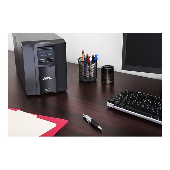

This is what I have right now.
1440VA/1000W line interactive pure sine wave tower UPS
According to the NMC as I type this, I’m using:
  1. About 30% of its output power in watts (or 24.1% in VA).
  2. But let’s put that closer to 60-65 percent; I have multiple UPSes in this room and I’d like to downsize to a single one. And those other UPSes are handling ~320w minimum.
Aside: This UPS uses lead-acid batteries, so if the health risk involves inhaling the outgassed fumes, I’m probably screwed. I’ve had this one in here since January 2022, and two other lead-acid battery UPSes for at least 7 years before that.
I chose this one less because I was planning to push it to the limit on power capacity, but because I liked its other features (line interactive, NMC included, etc.). It was on deep sale and I snagged it for a huge discount.

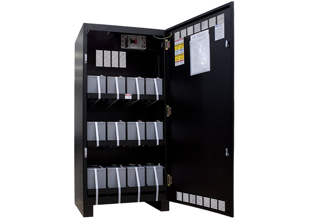

Now, if you’re in a situation where you HAVE to have a UPS and you want to rack mount it, I would start looking at enterprise solutions:
