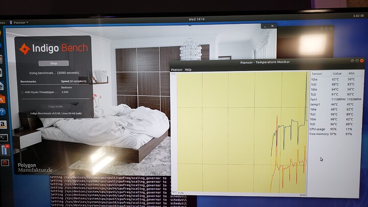

This bios will fix the governor issue – the final fix will be rolled in with the AGESA update in a few weeks, so there is no urgency installing this unless you’re having performance issues on Linux or you have cores stuck at the lowest frequency.
X399AORUSXTREME.ZIP (6.1 MB)

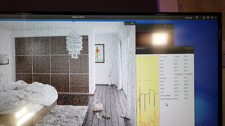

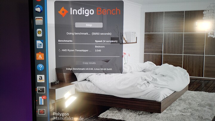

NOTE: THIS IS A TEST BIOS! e.g. use at own risk! It is ONLY for the Aorus Extreme X399 and it ONLY fixes the performance governor problem on 4.15+ BUT with this PBO bios controls seem to work perfectly with excellent control of VRM thermals, etc.
As you can see with this bios I can keep the die temp around/under tjmax of 68 AND overclock the frijoles out of this 32 core monster.
EZ OC 1 hr stability with PBO. PBO is the real champ here… More testing underway, obviously…
