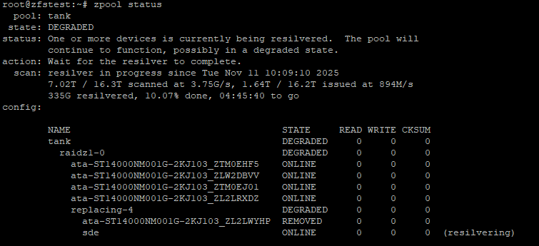

so far the Minisforum n5 pro seems solid:
this is resilvering onto a blank drive after the pool being filled to about 13tb/37tb:
 zfs list
NAME   USED  AVAIL  REFER  MOUNTPOINT
tank  13.1T  37.6T  13.1T  /tank
c1:00.0 SATA controller: JMicron Technology Corp. JMB58x AHCI SATA controller
This sata controller does run hot, and will go sideways if it gets too hot, and is not as good as other JMicron controllers, but so far knock on wood hasn’t done anything untoward. This is the second back-to-back resilver with a fresh drive in a z1 pool. @Sasquatch1
