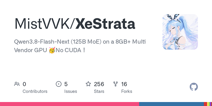

Anyone try XeStrata on Intel Arc?
Curious about the above given the below news:
XeStrata:
As the only remotely reasonably priced 32 GB card is an Intel Arc, I’m curious about this from a hardware savings perspective.
