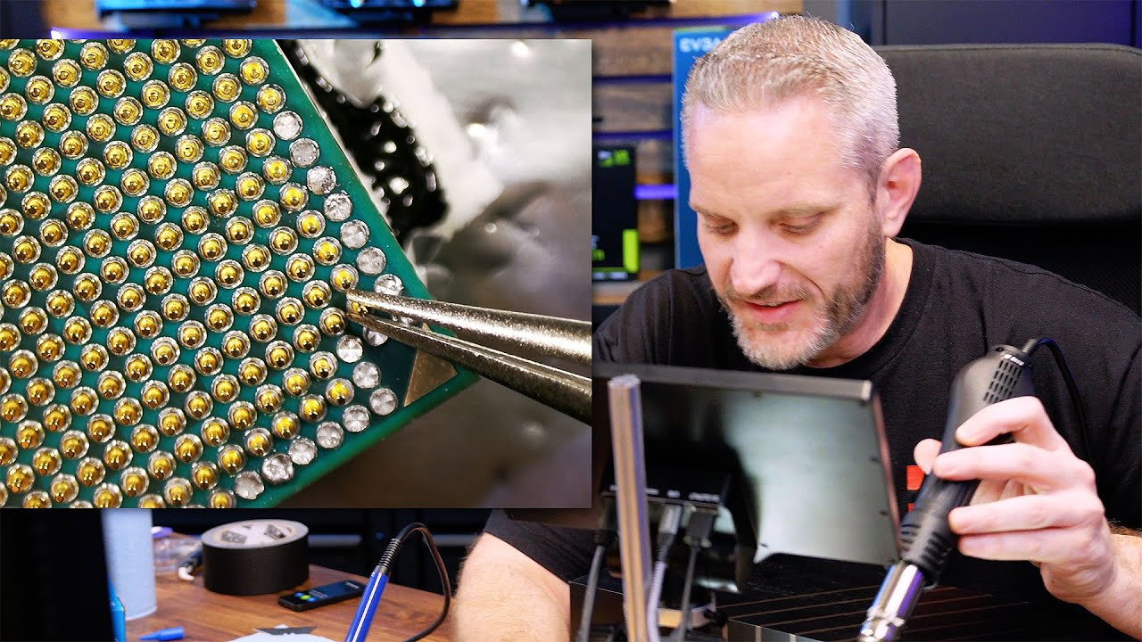

if the pins aint snapped you can with care bend them back into place…
problem is though…
if its anything over a 45’ bend theres more than a chance the pin will break.
so its entirely up to you if you want to risk that…
you could also take the chip to a solder station (an electronics repair shop that does actually electronic repairs not just swaps out parts) some one like louis rossmann. and get them to desolder the broken pins and replace them with new.
wont be cheap…

My method is to use an empty 0.5 mechanical pencil. Simply fit the bent pin into the cylinder, and gently bend it upright. I’ve fixed several PGA CPUs this way. If you have a relative with steady hands, let them give it a try.
