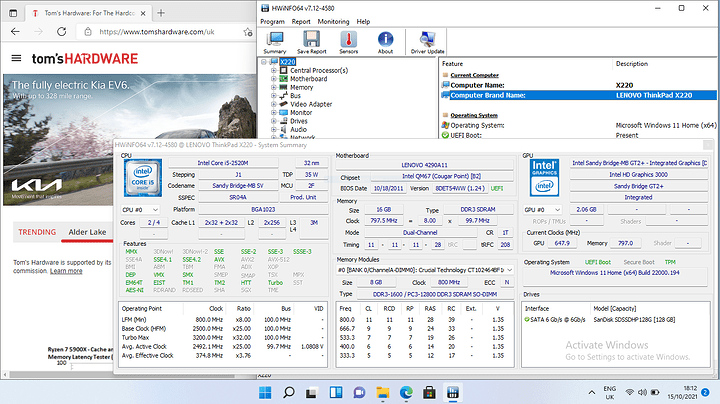

Sata cable stuck out a gap somewhere and old ssd . I would not leave it connected, tho. Using Rufus to build a modded windows install will allow you to use window 11 with having to have windows 11 approved hardware tpm 2.0 .

Other than that, afaik Rufus has an option to create a windows to go image from an iso.
