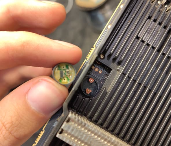

Since it works fine temps wise I’ve opted to just remove the beeper from the GPU. They are second hand already so I think its fine. The beeper fell apart as soon as I heated its pads a bit so maybe it was already bad itself? Unsure.
amd-instinct-mi50-removed-beeper1
Well, there’s no putting it back on, now :grimacing: :grin:

Hey can you help me friend,i have a 16gb mi50 that i bought from aliexpress that is behaving similarly to yours, in my case i only have one card,initially i thought the beep could be related to it being overheating so i got myself a custom cooling solution, also from aliexpress, since the bios that came with the card did not show the temperatures i had to flash a custom one, everything went well and after flashing i could see that the temperatures where just fine while idling but after a while it would still start to beep the same, while gaming the maximum temperature on the hotspot was around 85 degrees so i crossed out the possibility of overheating, after that i thought it could be the power-supply not handling the demand from the GPU, so i got myself an 850w gold rated power supply from XPG, and the card still does the same thing, i am almost doing the same thing as you did with this beeper, but i am afraid of running the card on this state on my system and damaging any other component, how was your build after you did this ? did it all survived ?
Yea everything was absolutely fine after removing the beeper, its fairly easy to get to on the board and it behaves just fine with it removed.
