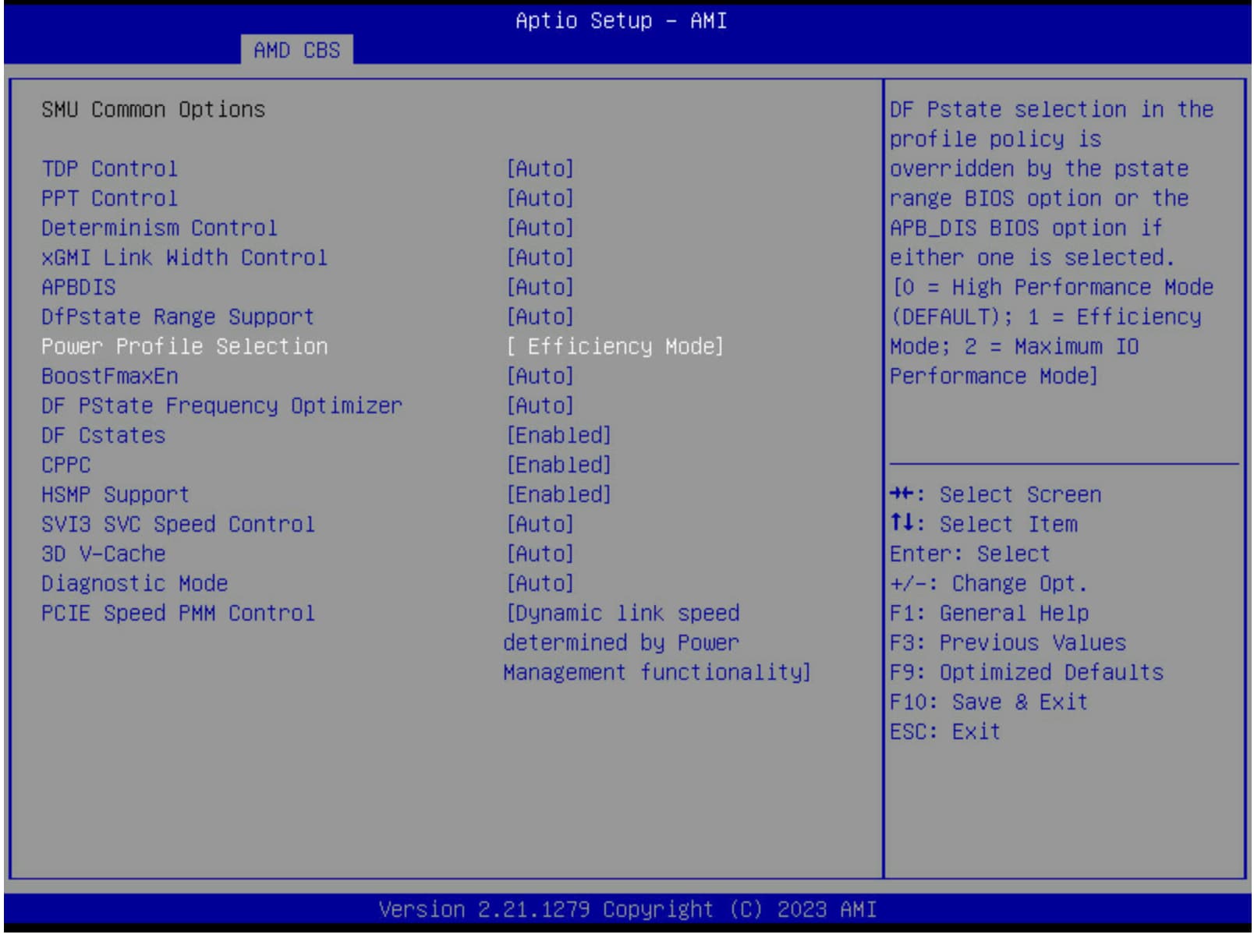

I’m using Proxmox as a hypervisor and now I’m looking for the most energy efficient BIOS/OS settings for this setup.
I’ve started with 160W idle power consumtion, now I’m down to 120W with following BIOS settings:

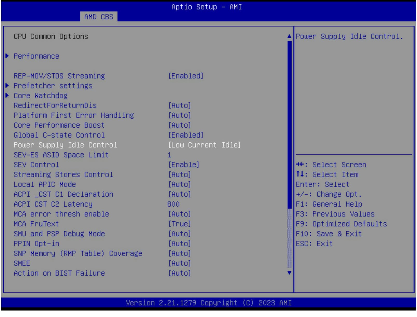

Global C-state Control → Enabled
Power Profile Selection → Efficiency Mode
DF Cstates → Enabled
CPPC → Enabled
HSMP Support → Enabled
PCIE Speed PMM Control → Dynamic link speed determined by Power Management functionality

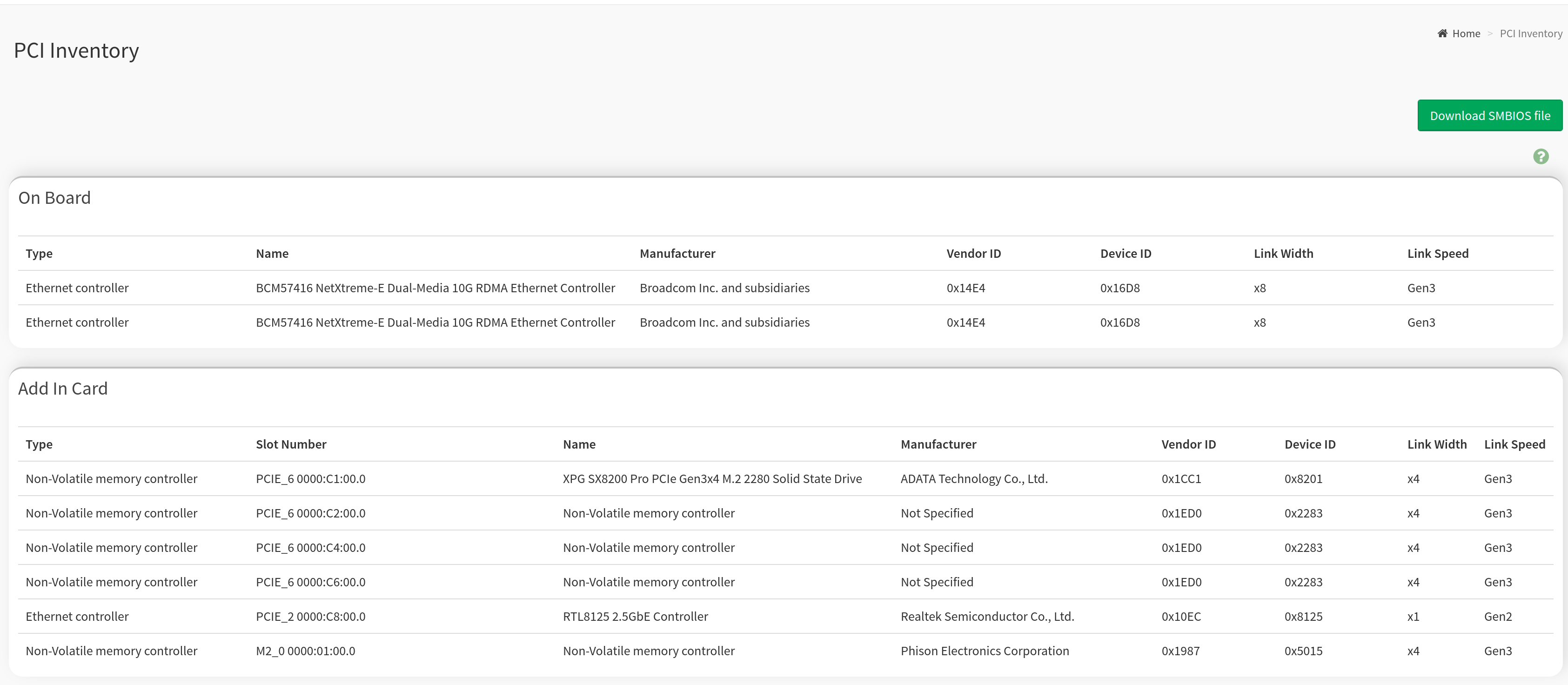

What interface are those Micron drives, U.3? How did you connect them, MCIO? Where did you get cables?
Yes, U.3 drives connected via MCIO.

The CPU is in C2 most of the time.
As far as I can see the CPU doesn’t support any states deeper than C2:
root@proxmox:/sys/devices/system/cpu/cpu0/cpuidle# ls
state0  state1  state2
root@proxmox:/sys/devices/system/cpu/cpu0/cpuidle# for state in state{0..2} ; do echo c-$state `cat $state/name` `cat $state/latency` ; done
c-state0 POLL 0
c-state1 C1 1
c-state2 C2 800

                LnkCap: Port #0, Speed 8GT/s, Width x4, ASPM L1, Exit Latency L1 <64us
                        ClockPM+ Surprise- LLActRep- BwNot- ASPMOptComp+
                LnkCtl: ASPM L1 Enabled; RCB 64 bytes, Disabled- CommClk+
                L1SubCap: PCI-PM_L1.2+ PCI-PM_L1.1+ ASPM_L1.2+ ASPM_L1.1+ L1_PM_Substates+
                L1SubCtl1: PCI-PM_L1.2- PCI-PM_L1.1- ASPM_L1.2- ASPM_L1.1-

Thanks for sharing. I copied your settings above plus added immediately below Global C-State Control, the
Power Supply idle control = Low current idle.
Now I’m at 60 w from wall with the two onboard 10Gbe + Lan 1GBe plus extra pcie 2.5Gbe and 5 Nvme PCIE 3.0 and some Noctua fans. But only one single RDIMM of 32Gb so far.
The power supply is a regular Corsair RM850e.
