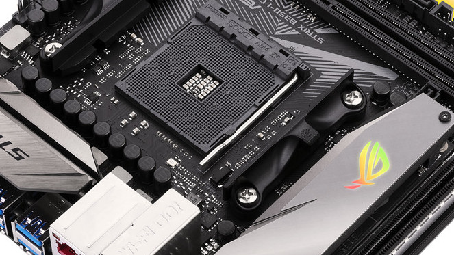

Looks like Asus is going to have their ITX board out soon. So far the B350 has popped up:
https://www.inet.se/produkt/1901045/asus-rog-strix-b350-i-gaming
Finnnnaalllyyyy. (Now we just need the RoG)
Interesting, lets hope that Asus used a proper pwm.
more info about the asus itx boards and x370 this time too.
