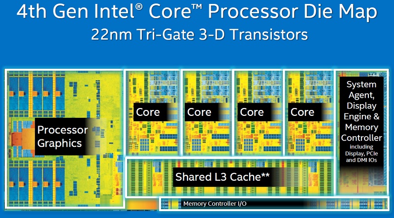

Actually Intel's socket changes have a reason and is not just a "lets screw the customer" sort of thing. The main reason for a change in socket is a change in architecture that requires a different pin layout than previous chips and the changes in pin count ensure to idiot proof the system. AMD had AM3+ for so long because they kept trying to keep alive an architecture that just wasn't all that great.
And on the Intel stuff I'll let the pictures speak for themselves
Core 2 Duo (socket 775)
Lynnfield (1156)
Ivy Bridge (1155)
Haswell (1150) (note the different iGPU)
Skylake (1151)
