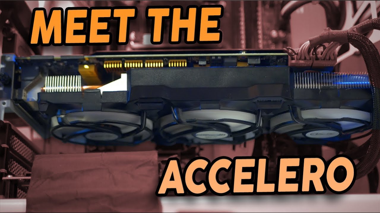

Those worked super well when I had my r9 290, the only issue was that the fan speed could not be controlled and was set at 100% but even then it was whisper quiet.
Oh hell yes, it's a ton quieter.
I mean, anything is a lot quieter than the reference but the Accelero are beastly.
also what @Big_Al_Tech said.
Though i think the III version may now have fan control, not sure.
The fans or the controller did eventually crap out but that was 24/7 on hours for 1.5 years.

Just to add up,look at the difference
IDK what Arctic is doing or why no one is colabing with them for the cooler.Its bonkers.
