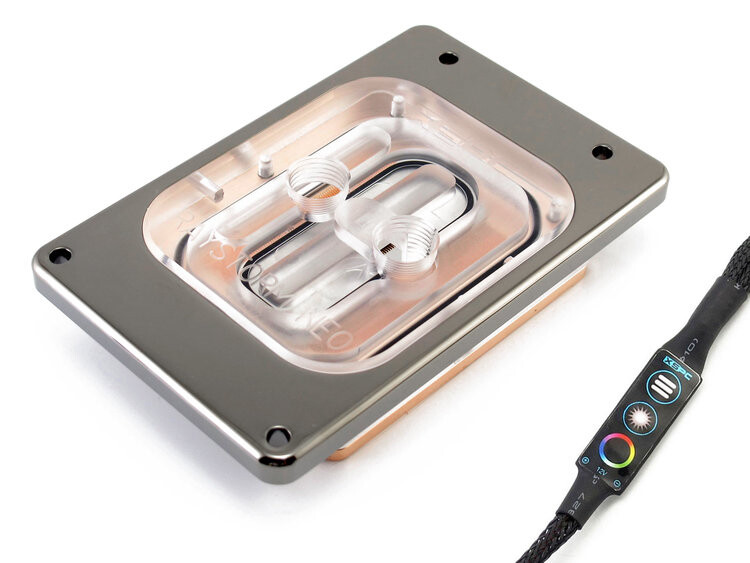

But if you already have custom loop parts except for the cpu block, I can recommend the Optimus PC Signature V3 Threadripper block. It’s what I use on my Epyc 7003 cpu hosts. Or the Watercool Threadripper block as second best choice.
