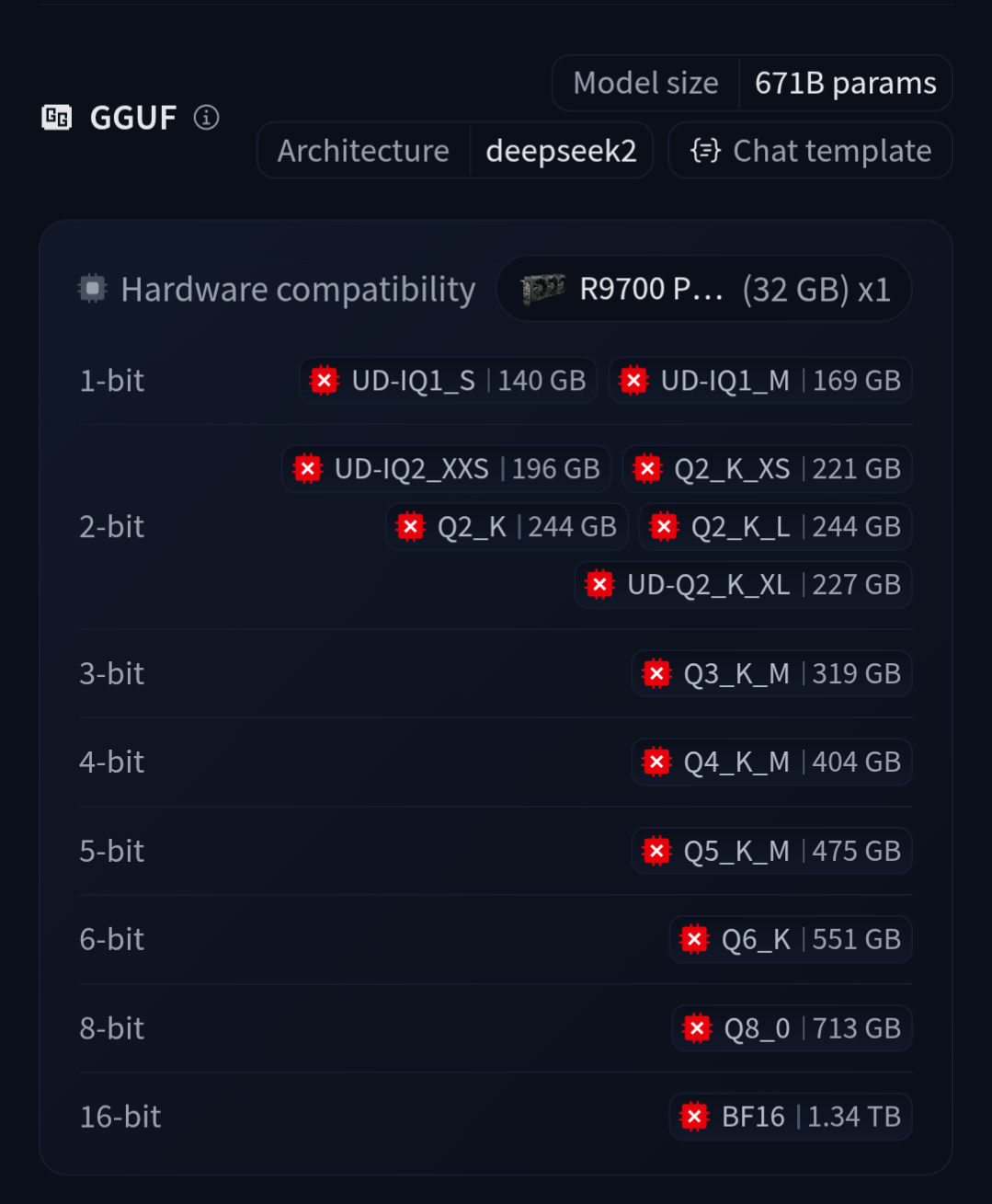

I must be missing something. All the massive R1 models I see are well over 150 GB in size!
Maybe you are picking a massively distilled model?
EDIT: ah, found the distilled version. Which is around 40GB for Q4. Yeah, don’t use that. We have much better coding models now.
So yes, it most likely is offloading to CPU/DRAM and killing your performance. Quite amazed you got it working really. 43GB VRAM sounds about right to leave 5 GB for context window, and the rest gets offloaded to CPU DRAM - at 15 GB/s bandwidth.
Anyhoot, DeepSeek R1 is old school and we have much better coding-focused models these days, like Qwen 3.6.
