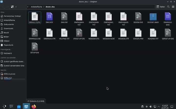

KDE Plasma and Dolphin recently integrated Dosbox directly into the UI. So you just “click" and exe, install the container, and it executed the old win16/win32 binary in Dosbox and pipes the output.
I don’t yet know the details for creating a persisted install, like my old MechWarriors 2 installer would want to do.
I would image it’s just making a custom mount for the container. Then it’s a matter of executing the installed binary within that container.
The end result would be you archiving that particular Dosbox version/binary and game install folder in a zip. Then unzip whenever you want to play on a machine that supports Docker/Podman containers.
