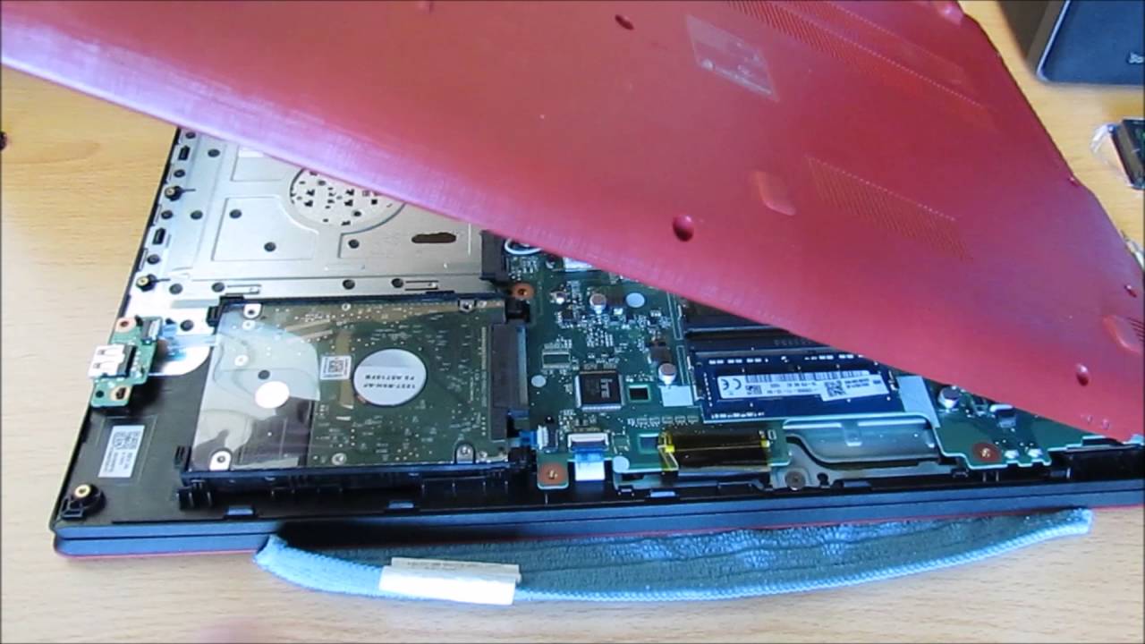

Did a little more digging, if you hasve an old laptop or can find one the wifi card looks to be replaceable, check
that might be worth it to investigate further :)
That does indeed look like it may have a removable wifi chip. In which case swap it out with an intel one.
If you want, open it up and take some high quality pictures of the motherboard for us to see.
