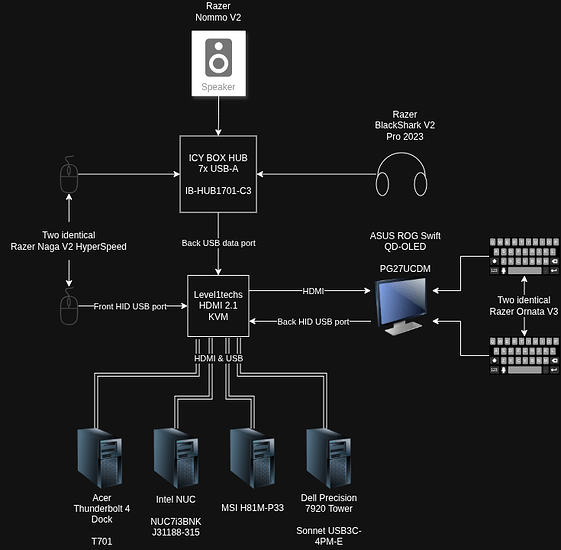

Since I had video out at this point I now needed a way to pass peripherals to those VMs reliably. The Sonnet Allegro USB-C card is perfect on paper: it has two ASMedia 3142 controllers, allowing me to pass one controller to each VM independently.
Here is the USB layout for my side of things:
And it worked flawlessly! Well… Until I started switching PCs on my Level1Techs KVM. The controller inside the VM would freeze the entire VM for like 3 seconds, then timeout, and then the kernel would kill it permanently with those error messages:

It is a disgusting hack, but it kinda works. I still have to wait about 30 seconds for the timeout, reset, and device reconnection, but it beats a hard reboot. Interestingly, this seems to be a Linux-specific issue as it does happen on the proxmox host itself too but windows VMs handle the KVM switching without dropping the controller. I suspect a flaky Icy Dock USB hub might be contributing, as the KVM’s emulated HID ports don’t trigger this on their own but on the other hand maybe the KVM does something to the USB 3 connection that the ASMedia controller does not like, I cant tell at this point.
