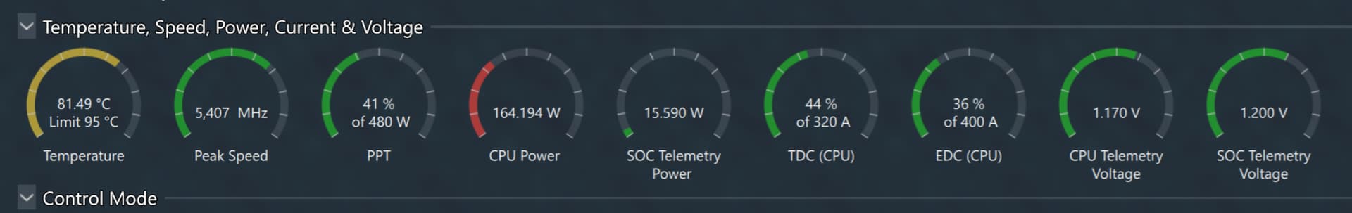

Now we get to the closest I could achieve to the same CineBench R23 score I got as a maximum for my 7950X result above after a 10-minute run with my 9950X.
Here are the stats for that run after the system had reached homeostasis. My system was running at a voltage of 0.97 Volts Set (and I have been running it 24/7 like this for a couple of days now, chucking various loads at it without any problems).
To get the same result as my 7950X with a 360 rad AIO cooler, I could use a cheap, but good, $20 air cooler with my 9950X and still come out ahead on temp.
I am getting the same result with my 9950X as I did with my 7950X with 65% less CPU power draw.

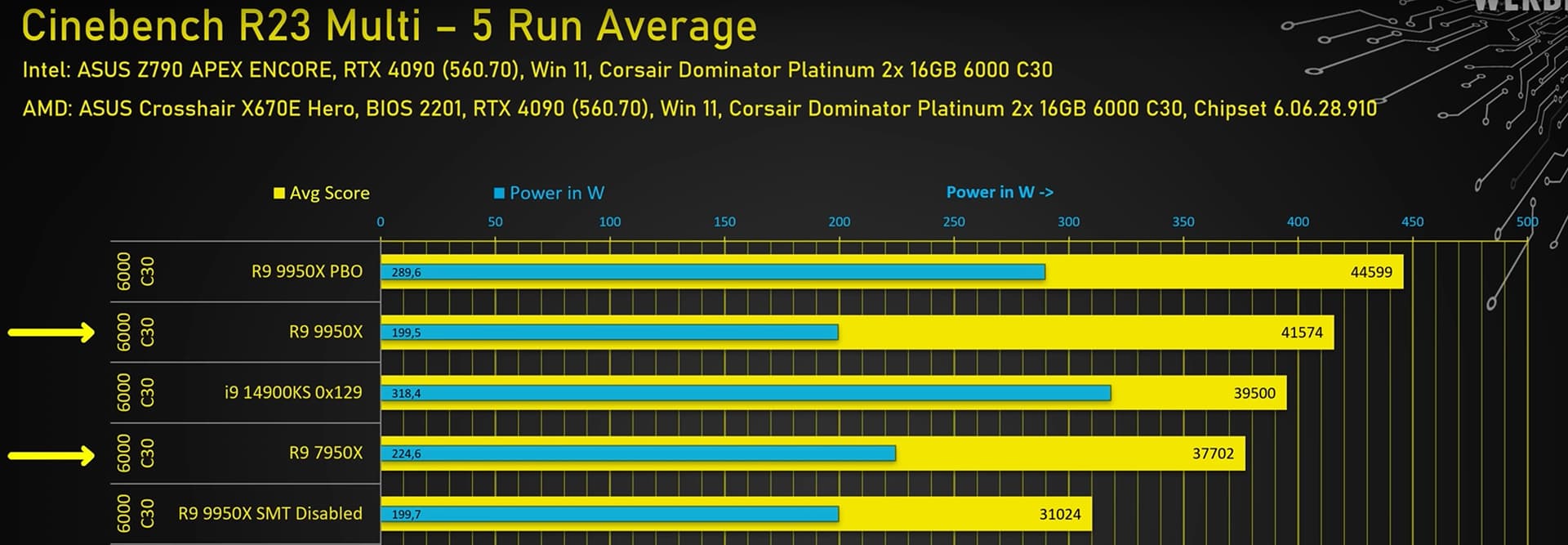

He got his 9950X, delidded it, applied liquid metal, and then did direct-die cooling and this was his result; his ambient room temp is also about 5 degrees Celsius lower than mine:
His CineBench R23 score was 44599, his power draw was 289.6 Watts and his temp was 94 degrees Celsius.

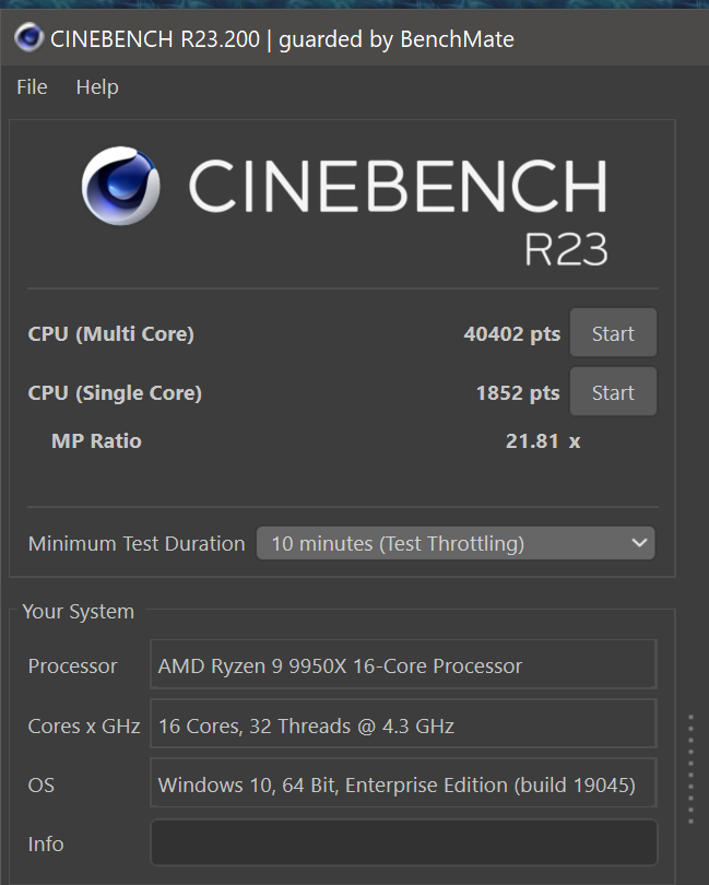

And here are the stats:
Of course, I did none of those fancy, delidding, liquid metal, direct die, things like Der8auer. All I did was slap my CPU into the socket and whacked on my cooler, like a pleb, (well that, and of course knowing how to configure Ryzen didn’t hurt).
That being said, compared to Der8auer, my score is over 3.3% higher, my power draw is 28.3% lower, and also my temperature is 13% lower than his.

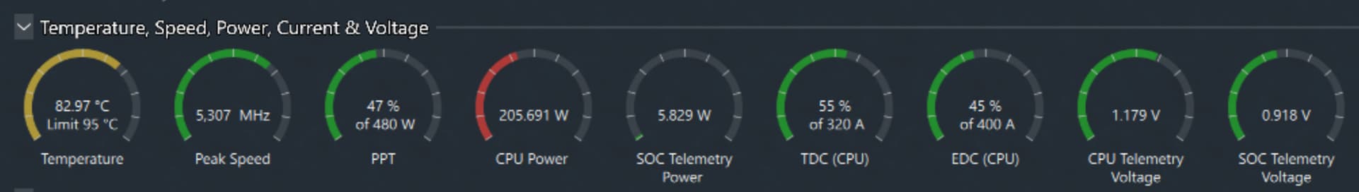

It is because at stock the 9950X maxes out the PPT at full load and will downclock cores to stay within that limit as you can see here:
CCD0 clocks to 5.166 GHz and CCD1 only clocks to 4.88 GHz under full load.
