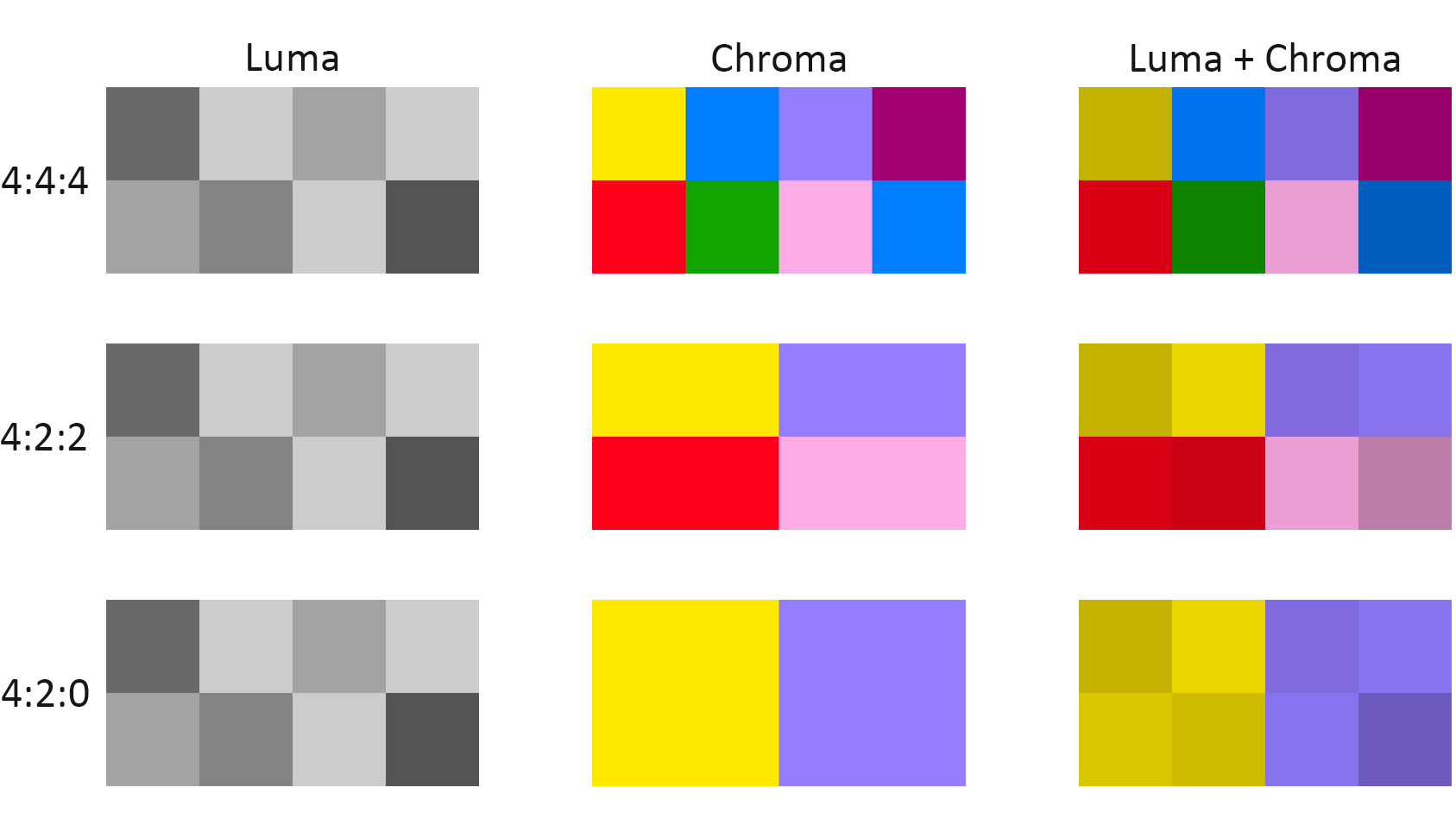

I would suggest you read this:
It explains it including pretty pictures
Isn’t 4:4:4 still RGB though, just with finer grading? Or am I missing something?
Most TVs will take an RGB input, some (usually older ones) don’t so you have the option to convert.
No, it’s still a luma channel and two chroma channels rather than three colour channels like RGB. 4:4:4 can be mathematically equivalent to RGB, as in it’s a 1:1 conversion, but it can also be in a different colour space which needs conversion.
Oh that’s what you mean, I see.
However, there is also this on the aforementioned link:
It’s also important to note that subsampling on a PC requires using the YCbCr/YUV format as RGB does not support it.
So unless the TV takes a pure RGB input there is no way to avoid it, as I understand.
Yeah, even though all TVs have to convert to RGB to display an image they use YUV for the signal because it can be compressed using chroma subsampling (all video uses 4:2:0). So if a TV doesn’t accept an RGB input or you don’t have the required bandwidth then it’s unavoidable.
The problem however isn’t just that you are compressing the colour, as this isn’t that noticeable (like I said all video uses 4:2:0), the problem is that a PC can only render in RGB and has to convert to YUV, which is usually done with a fast lossy method to avoid increasing latency. So setting your PC to 4:2:2 or 4:2:0 looks a lot worse than a normal 4:2:0 video, it’s especially noticeable around text.
