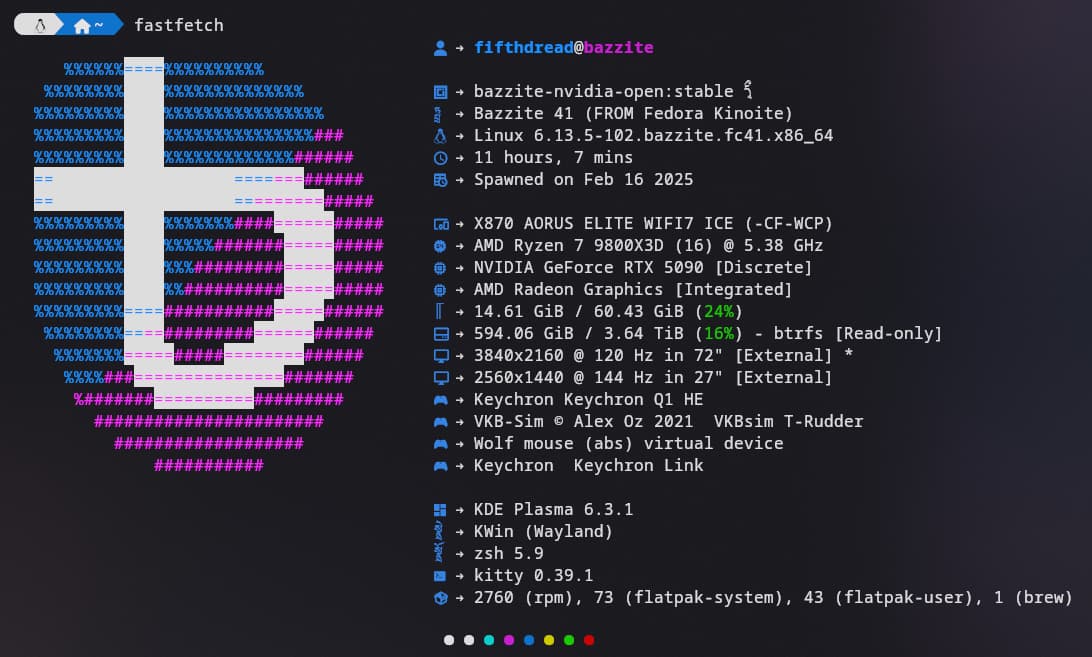

Bazzite is a custom Fedora Atomic image from what I understand, focused on gaming. Checking my fetch, It claims it’s Linux 6.13.5-102.bazzite.fc41.x86_64, I guess some sort of modified kernel?

Looking like what I think is the latest, 570.124.04
