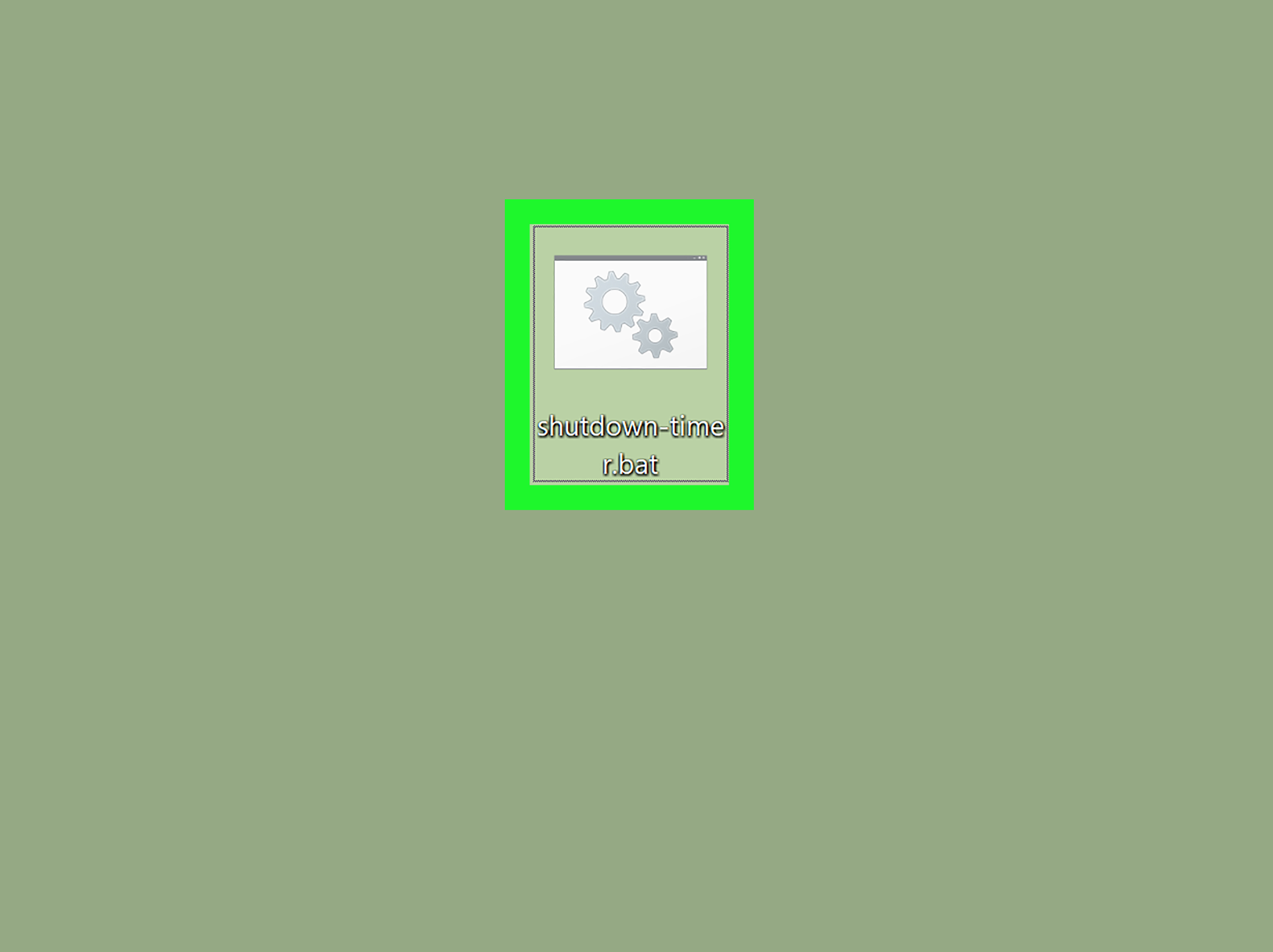

Smart power strip/outlet? Script to shut down after certain level of inactivity / time of day?
