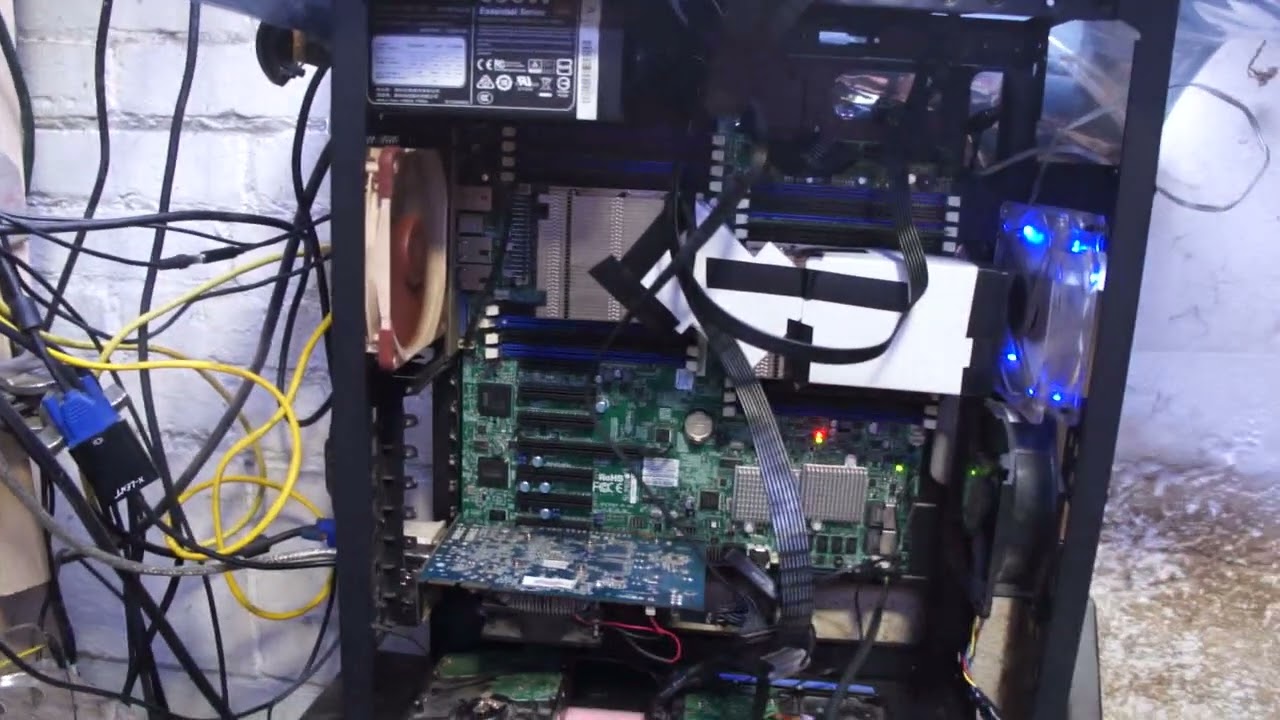

Well, if you come around on drilling new holes, I did it by mounting the board with what worked, marking where new ones needed to go with a mechanical pencil (not much long and narrow enough to do that), keep it perpendicular and trace the circle, then drilling those holes ever so slightly over-sized. The new standoff got loosely installed in the board, then the board installed, then tighten screws in new standoffs, then nuts on back of new standoffs.
That’s exactly what I did for this system.
