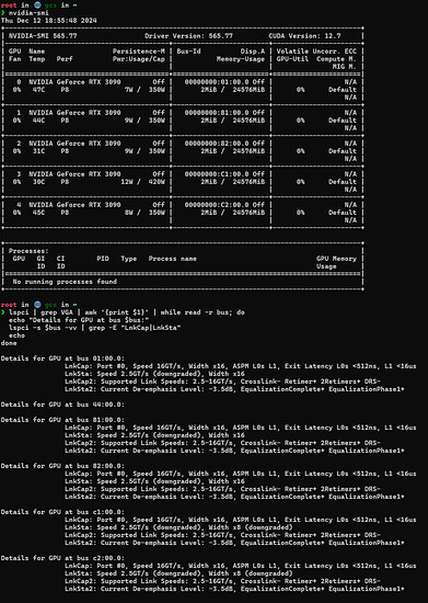

Screenshots from the bios:
I connected all the GPUs, and two of them are even worse, downgraded to x8 for some reason.

Since nvidia-smi shows they’re all idle, they would be in power-saving mode where it’s usual to disable PCIe lanes to save power. What does lspci show when you run one up to full load?
Picture one the bifurcation ones should be your pcie Options, what is there instead of „Auto“?
The only thing that lets me set is the bifurcation. x4x4 etc.
Put a load on the GPU and see if it changes. It won’t use its bandwidth if it doesn’t need to.
That’s the behavior I’ve observed at least

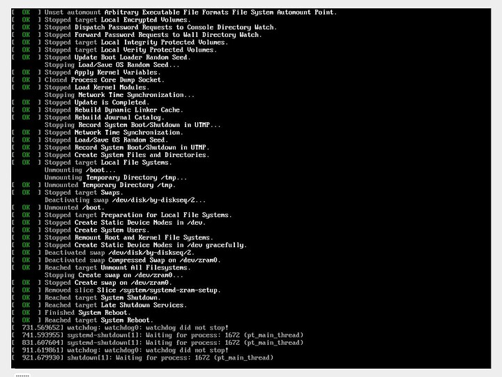

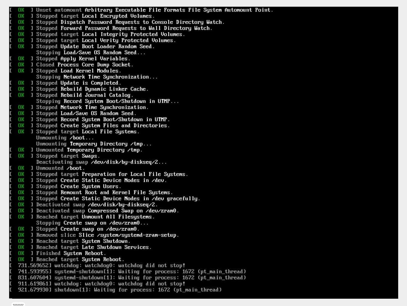

Reboot doesn’t even work in these situations without a hard reset, it blocks here

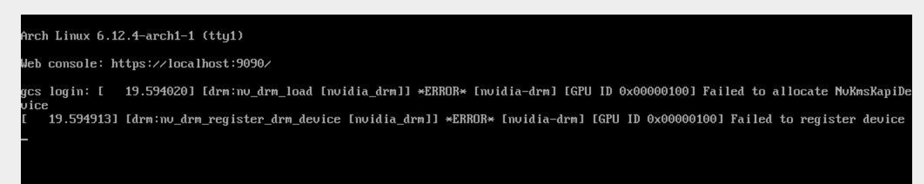

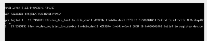

After rebooting again, one of the GPUs was no longer available and I got this:

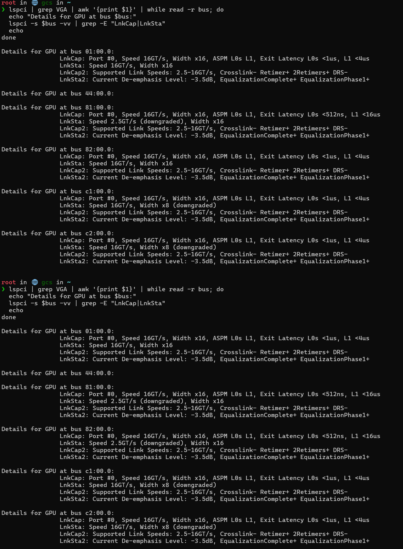

Interestingly it seems two of them got the non-downgraded bandwidth just randomly?

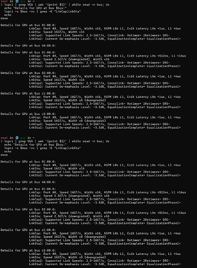

You were correct. It gives me downgraded even without risers. It took me a while to disassemble everything and I had to remove the brackets from the GPU to attach it to the mobo without the case, but I was able to connect a GPU directly.
First command is before loading a model into the GPU, second is after.
So it upgrades PCie 1 to PCie 4 speeds.

Now that I know the PCie version downgrade goes away when using the GPUs, that issue is no longer a problem.

I checked the PCie speeds using a manual command, and it always immediately goes back to PCIe 1.0 a second after the GPU stops being actively used and becomes idle, even if there is a CUDA context open, so I just didn’t see that it was upgrading to 4.0 whenever the AI model received a prompt (especially given I wasn’t using the server much, and rather spent all the time trying to fix this nonexistent issue)
