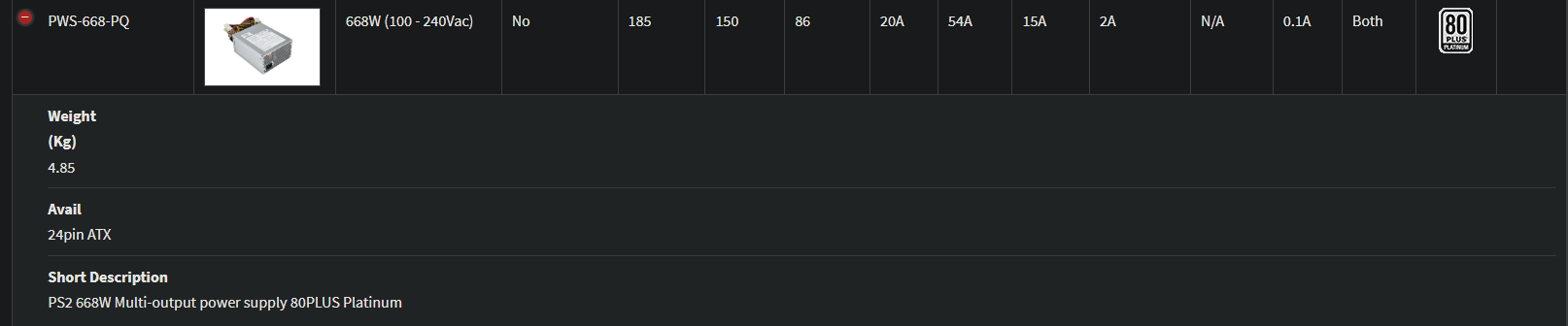

I think I am leaning toward the industrial route, such as the above-linked supply, but again, I need to know if it will properly support the motherboard / CPU we are using (does it have the proper connections?).
tbh I cant find anything and the datasheets are shockingly poor.

In the case of being unable to confirm the Seasonic capabilities, I think I will go with option 1 (SFX w/ ATX adapter). Hopefully the inch of headroom gives enough space for the top-intake fan to breathe.

:warning: NEVERMIND, single 8-pin EPS
Ugh, okay I’ll budge. Prior to purchasing an SFX w/ ATX adapter, I will try convincing them to return the cases and go for the one that @infinitevalence suggested (Supermicro 6027r, above).

What about the PS that comes in the one you linked to. Would it (or the bundle in-case) have 2x 8-pins?
EDIT: Put another way, given a budget of ~$400-450, what case/PSU combo would you recommend for the build at hand? If I’m going to suggest anything, might as well make it good.
Also, time is of a premium, so US-based source is ideal.
Call and ask them, TSS is generally fantastic to work with. 90% sure it does based on the requirements of the listed/existing motherboard on that server and based on the power distribution block (PDB). The good news is that you can buy different PDB’s for cheap and swap them out as long as they are the same compatible number of contacts (fingers). The PWS-920-1R is a 19 contact (finger) PSU.
