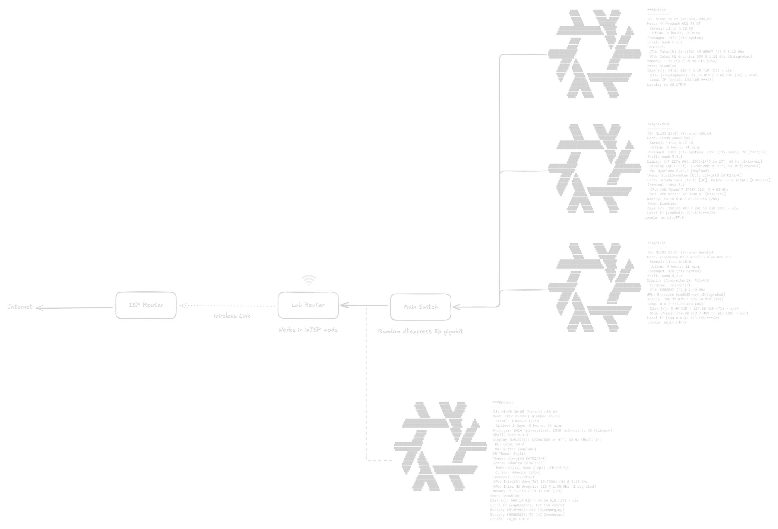

Hello, I am a long time linux user who recently got into self hosting. Making this thread mostly to share the random things I’ve discovered and to receive any helpful feedback/tricks from a community I’ve often lurked in.
This is my current setup. I can provide more granular description at a later date. Documentation is not my strongest suit and with these posts I will try to improve it.
I have a 5th node that I’m still setting up. It will be dubbed nixbox as my test environment. I will probably use it as a nix remote builder for the lower powered nodes like nixpi and nixer.

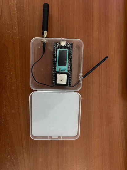

Progress on this has been okay. Working on it between family and rest. I got some Heltec Wireless Trackers early this year for an IoT project. I later learned of the Meshtastic project and tried it out. It’s pretty neat but I am probably the only node in my entire country.

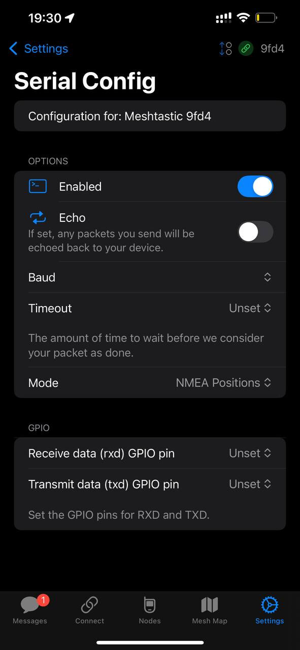

The idea was to have on these on a water tower and get good GPS fixes that would be transmitted to a module connected to a server through USB. Meshtastic allows you to log NMEA packets straight to serial.
Thought it’d be way straightforward after this but …I cannot turn of device operations logs from appearing.
Attempts to use them as is have crashed chronyd. Currently working on creating a service to read this, filter the unnecessary fluff and present it as a device. The code is clumsy at best. Still trying to iron it out. Any help would be appreciated. Wrote this piece with the help of GPT but it didn’t quite workout. Will give it a try again later tomorrow.
