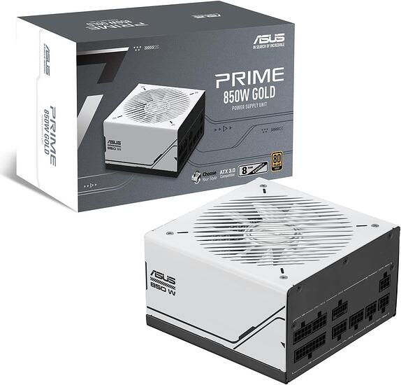

PSU wise - Corsair and Asus, have done White PSU variants
