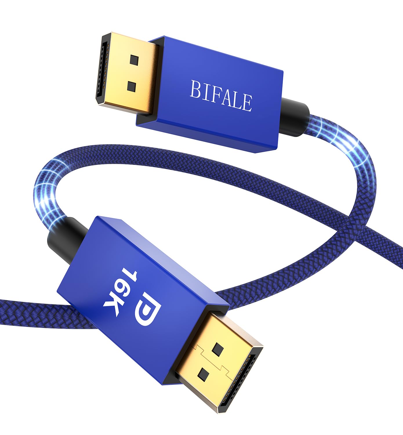

My pc is remote in another room of my house and I have been successfully using 25ft displayport cables to drive 32" 75hz 1440p monitors for a few years now. I have recently upgrade to a alienware ultrawide AW3420DW, and when I set the display to 120hz, I get blacking out randomly, or it looses the display signal totally and I have to restart to get it back. I know 25ft is pushing it for the cable length, but does anyone have any recommendations on a cable?
I got this cable off amazon thinking it would solve the issue, but it is not any better.
