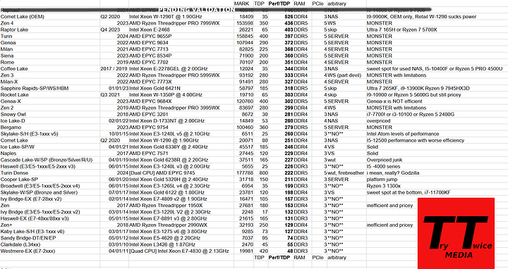

I now realize why no one has done a broad enterprise hardware comparison across generations.
I compared 1600 CPU’s to land here… 1 chart to rule them all
Long story short; If it has DDR3: Do not buy it in 2025, but DDR4 does not make you safe from the electric company.
If your goal is to build the baddest firebreather of a server, lookup cpu benchmarks and work down from the top until you find one you can afford.
For the rest of us that actually pay for electricity: Performance per watt TDP is our golden ratio
donuts per dollars, or how fast per watt is our tangible driving factor
There are tiers to this: you probably don’t want a 300 watt TDP CPU in your NAS or a 40 watt TDP CPU in your virtualization server.
Onto the chart:
This charts the peak performers per generation, but saving y’all the math: on average each CPU generation is 50% less efficient than the best performer listed here.
The exception being the old DDR3 Intel Low power L sku’s from Skylake v5 and older where per generation efficiency average 80% worse than the L skus.

Out of curiosity: What test was run in order to come up with the mark numbers? I’d like to run it against the machines in my fleet to start making choices about what to do with them. :slightly_smiling_face:
I pulled from cpubenchmark.net’s passmark database and testing suite:
PassMark PerformanceTest - PC benchmark software
Having ran this same benchmark on literally hundreds of machines (then wiping and deploying clean installs), I trust it to give me a standardized CPU benchmark as most clean installs and builds net results within margin of error of the passmark published results.
is a product of the error margin published being high, and zero coverage of this CPU. Realized yesterday this decision cost $2k+, but if it’s truly the efficiency monster I suspect it to be:

Chart updated to add Comet Lake OEM, Comet Lake, and Rocket Lake
unsure how those fell off during the review
much to no one’s surprise: nothing changes
Intel’s Comet Lake OEM sku is the only outlier, but unobtainable and the same price used as a new EPYC 4004

Thanks for compiling this. Could you post a link to a CSV version of this too?
The Comet Lake is a standout for performance / w. Do you know how any of these idle?
TDP (Thermal Dissipation Power) is a rating for heat output, not electrical consumption.
Do you also have the electrical power consumption figures? It would also be interesting single core versus multi core.
you are absolutely correct, but that is not how the industry uses or derives TDP.
TDP is used as the design envelope for the CPU package and since a CPU’s TDP is a closed system (all energy entering the CPU is considered converted to heat) with the output being logical operations performed plus heat.
It’s supposed to be the wattage a CPU converts into logical operations at peak load with heat as a byproduct.
I measure that against the benchmark scores to give an efficiency at par value.
You’ll immediately say, but the par is different per CPU and be correct.
What we end up with is tiers of performance versus efficiency of that logic operation against thermal output via power consumption due to the way TDP is derived to begin with. BUT the efficiency yardstick is equivalent across all those tested.
To chart properly, it is 3 dimensional.
Net output is single dimensional and perfect since you don’t want a 400 watt EPYC for your media center NAS next to the TV (unless you do), or a 65 watt EPYC on AM5 as your VDI server in a medium sized enterprise (this actually, is a bad idea…)
in summation, I flattened a 3 dimensional problem into a single figure…
is answered by TDP as the way TDP is derived and in conjunction with the benchmarks we render peak efficiency as the electrical load is derived from the TDP.
THE standout for performance per watt is actually Raphael EPYC on AM5
it’s the obfuscate top line.
But it was so far above everything else, (50% above Comet Lake) I bought that model (4464P) and am in the process of validating it as I type this.
yeah, the arbitrary category was the only way I could convey the net result of this research.
I was genuinely shocked by the results.
as mentioned in the original post, each CPU family has on average 1 performer that is about 50% above the rest of the lineup. This works in our favor since lower tier CPU’s from a family tend to be more efficient than the top performer, which isn’t necessarily reflected accurately by used prices.
Enterprises extending life cycles will upgrade to the top performer a socket can support which pushes demand to the top performers.
Ironically, the most efficient performers will have their values plummet on the used market.
Since we are measuring peak efficiency under load, you are getting maximum productivity per watt converted into heat.
I’d say go after the most efficient offering when it fits your budget, but calculation of initial cost versus efficiency is a compound equation that requires load calculation.
i’d have to remove alot of cursing from the comments section, but yes. I would like to publish the complete chart.
The assumption here is TDP as a representation of the max power drawn, which at least for consumer processors is not the case at all. I understand that its useful to make this comparison more feasible though.
The other assumption is that if the CPU is not taxed to its maximum (e.g, a fully single-threaded operation or lighter loads) that the performance per watt at max also translates to performance per watt at lower loads. I’m also not sure how accurate this is.
Since you have the processor, could you also do benchmarks for single-core performance and also check how much power it uses at idle? Look forward to the results.
Which processor is it for each CPU generation? Is it already in the table and am I missing it? This would be really useful to know.
I don’t think anyone minds :d

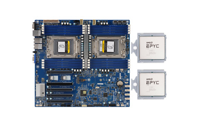

I am currently having an eye on Epyc 7773x combinationes like these for an AI rig.
  1. 2x AMD Epyc 7773X
  2. 1x Gigabyte MZ72-HB2
  3. 3x Nvidia Tesla P40
  4. 2x 512GB DDR4
Should be able to run two full models on CPU and up to three condenced models on each of the GPUs. Plus two times 512GB of main memory. Does not look bad for about 5500€ of investment.
