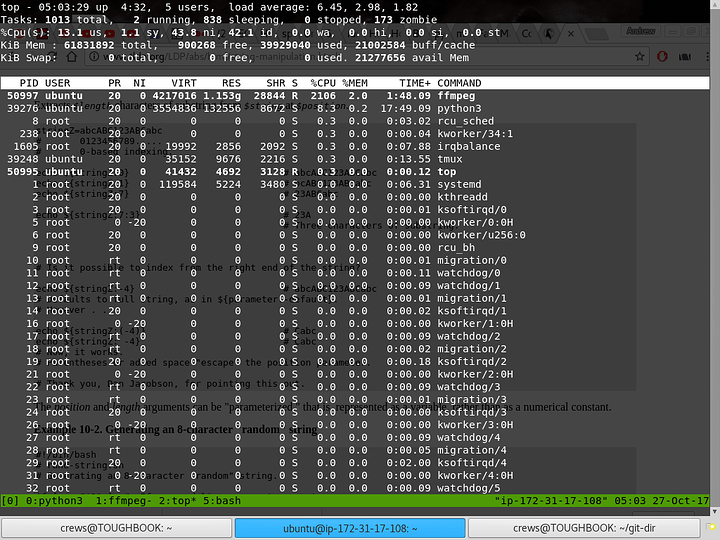

So I’m transcoding video with ffmpeg on an AWS instance, and I wanted to make sure I was using the cpu to the best of its ability.
The command I ran was:
for f in *.webm; do ffmpeg -i “f" -strict -2 "{f:0: -4}mp4”; done;
and t does seem to be transcoding properly, but top is showing very strange numbers. Does anyone know why this would appear that way?
I also tried with -threads 16 and the results are identical
Thanks,
Andrew
note: each thread is represented as 100%, this is ok.

Well, this thread certainly has been very interesting. So far I’ve learned quite a bit, but does anyone know why the %Cpu load numbers are strange? I would have expected ffmpeg to put the overall cpu usage to 100%, or close to it. It always does on my windows machine. I have seen per-process %CPU numbers over 200% before, and I always assumed that indicated for example, 2 cores at 100% each. This 2106% seems to indicate over 20 cores at 100% each? I thought maybe something like turbo boost would cause this result, yet the overall usage in the top left is only 13% Confusing

2000% on a less than 20 core system makes no sense.
Try passing --threads 32 to ffmpeg and look at whether overall system idle number reduces.
Also, you have multiple files, run multiple ffmpegs in parallel. Depending on the codec and video, a single ffmpegs may end up not scaling perfectly with the number of cores.
