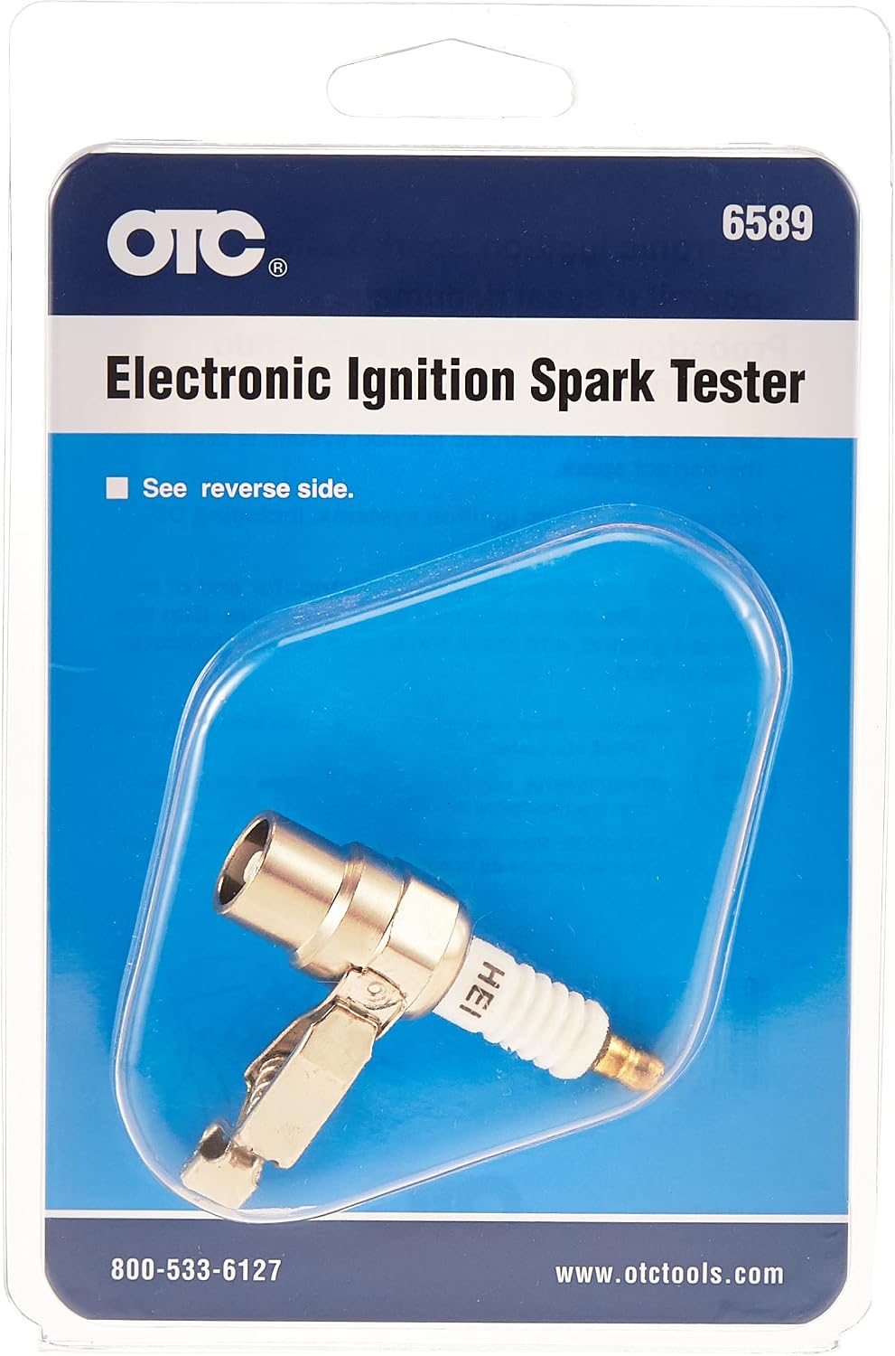

If you still have issues, move on to the wires. To test the wires, you can get one of these:
But it might be more cost effective to just buy new wires. They're usually only like $30-$40.
