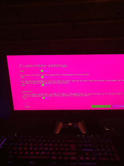

Hello,
i tried many times to get PCI-Passthrough via KVM in arch to work and succeeded in doing so after ditching X58-Asus-Boards because they have some VT-d issues. I use a
Dell T5500
X5675
6x4GB Registered DDR3@ 1333MHz
RX 480 8GB
The Linux card is a FX 1800 until i buy a better one when the Virtual Machine runs.
I followed PCI passthrough via OVMF - ArchWiki and used pci-stub because vfio-pci wouldn’t claim one device of the Card.
IOMMU and DMAR are working just fine.
The machine works but with wierd colors as seen above. When Idle, the CPU is around 25% as Windows Task manager reports, it is slow as hell and when i install graphics drivers i cant see anything. Wait a bit, reboot the machine, no picture after UEFI boot logo. I tried a 1070 from a friend once. CPU load was the same, but with a working Picture after driver install.
Why? What have i done wrong? Is it because i dont have a UEFI? If so: SeaBIOS clients are an option i never got to work but admittedly i have not invested too much time into it. Would Sandy-Bridge be a better option? 2011 Boards which are ECC compatible and working VT-d are very expensive. I want to reuse my RAM if possible because RAM is sooo damn expensive. Some good recommendations are appreciated as well.
Thank you for helping. Have a great day
That’s a problem. Did you stub and then bind vfio-pci to the card once you’ve booted?
No. I scrapped vfio-pci completely and only used pci-stub.
pci-stub is deprecated. Don’t use it.
That’s your main problem.
Well ok. That might explain the weird colors, but not the performance, am i right? Why is the Performance soo bad, even when using CPU-Pinning?
Let’s fix the GPU issues before we go after the performance issues.
