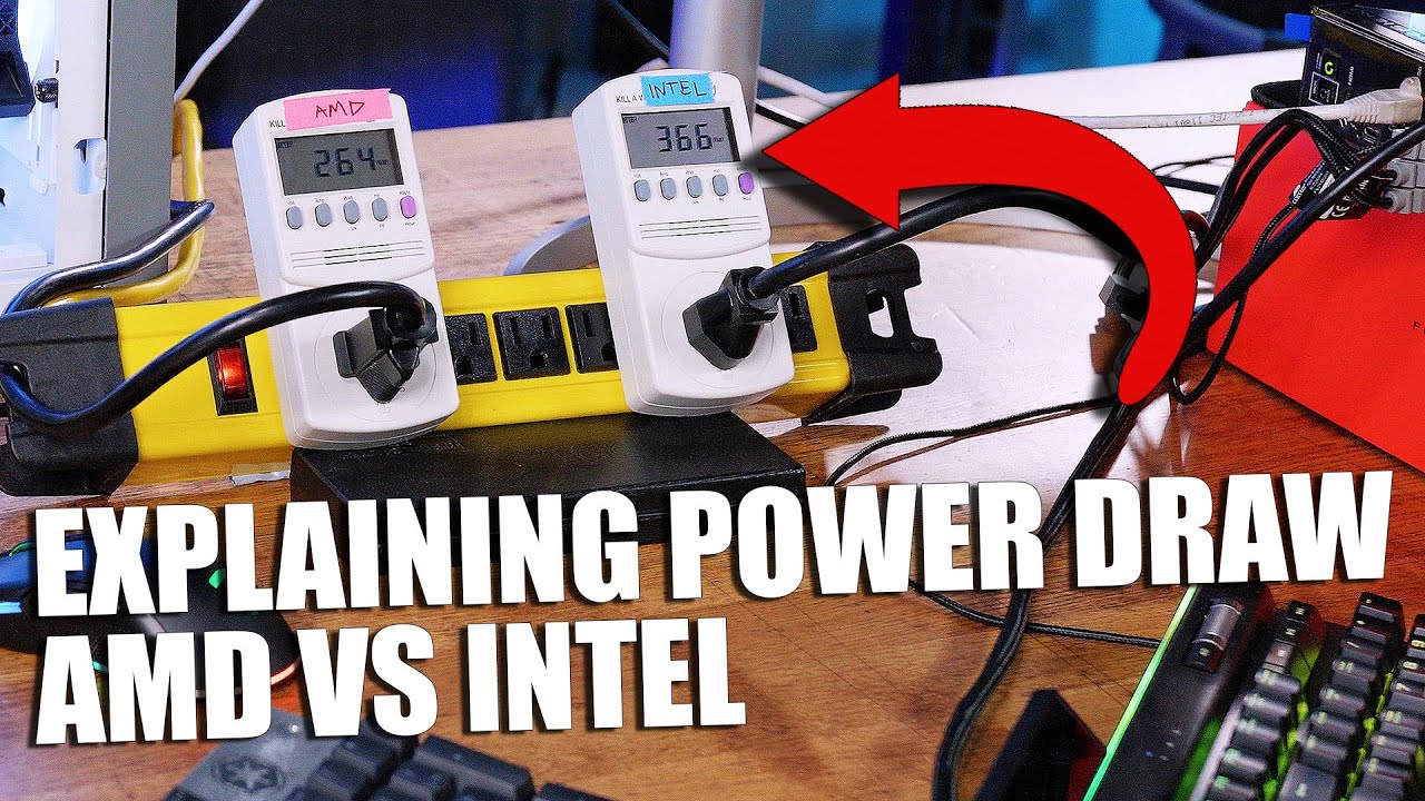

This is interesting
This time showing on a 24t v 24t 12900k v 5900x and the intel cpus idle to max watts usage DELTA was more than AMDs TOTAL usage. Intel using 50% more power.
And here I am running Ryzen 7 off of a 3 phase…
I had to watch the video to understand the nuance of what you have written :smiley:
Good find.

The thing is, 5950X still consumes less power than any of those…
It’s weird…
AMD is insanely efficient and a bit slower. So you can think Intel is faster, but on the other hand Ryzen is platform cheaper and easier to deal with when it comes to power and cooling. Cause god knows GPUs aren’t getting any efficiency progress. They are getting more and more power hungry.

I mean, I have a Ryzen 9 3950X and I can very much do the same. If I turn off power limits and turn my all core up to 4.2GHz I can get similar power characteristics to this and have my CPU sitting in the 90s Celsius on an NH-D15. If I actually wanted to get the advertised 4.7GHz single core boost that AMD printed on every single box that this CPU came in it would take a triple cooler, manual tweaking and power usage like what Intel is showing here. At actual stock I get 3.8GHz all core and 4.2GHz single core and power and thermals are reasonable, but let’s be real about how much AMD’s marketing lied for the 3000 gen. If we’re going to tear Intel a new one it shouldn’t be because they were actually honest about power requirements.
tl;dr In my experience AMD’s power usage is only decent because the clock speeds advertised are completely mythical – or you manually overclock to the “stock” settings and power usage goes through the roof. You get one or the other.
