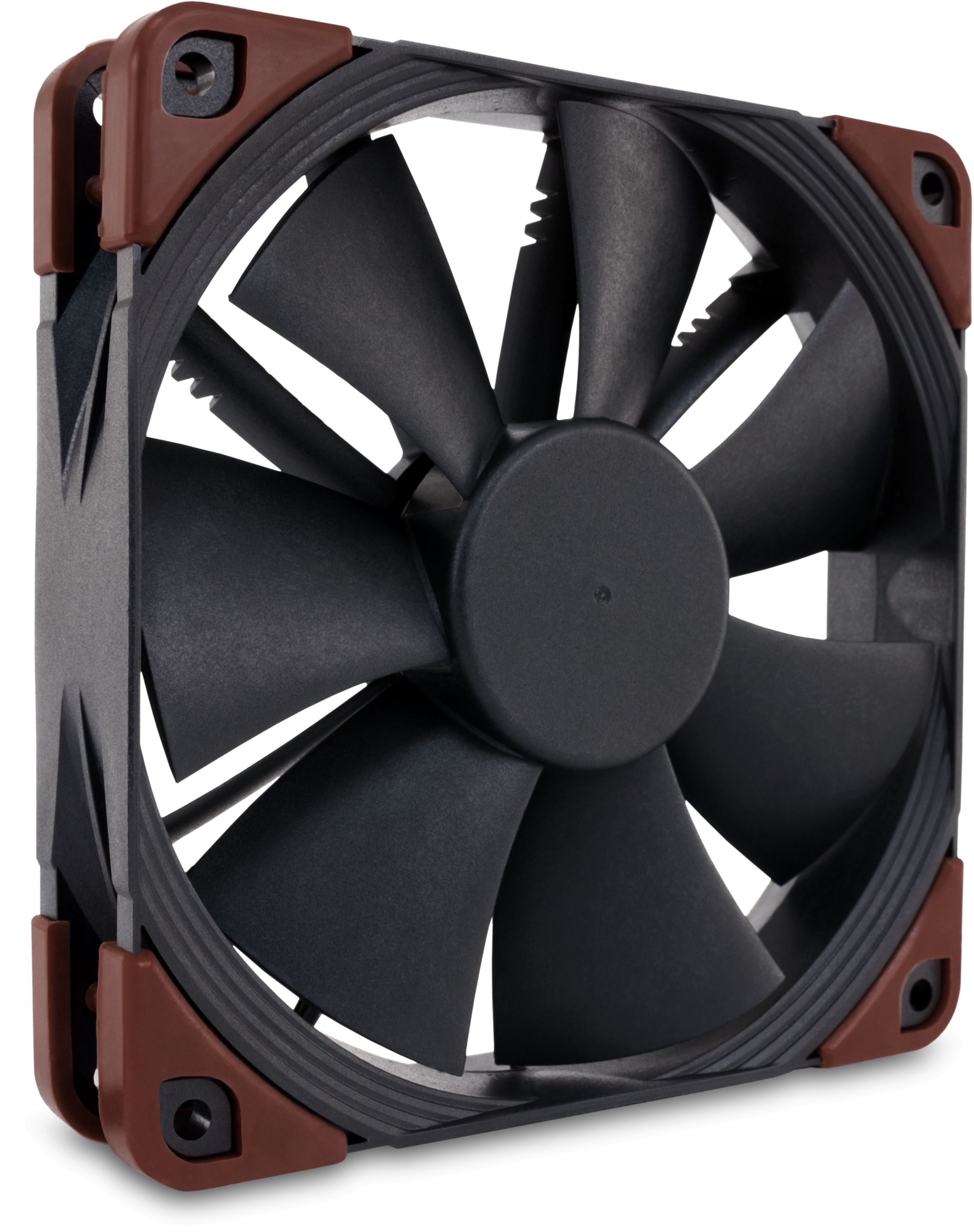

Noctua's NF-F12 industrialPPC-3000 fans do ~110CFM, and the max input power is 3.6W.

I do and a fan controller. Those fans are $20+ and I will never understand why Noctua pick that terrible color for their fans. I will keep looking.

Um, the industrial are pure black and run at 3000 rpm...
